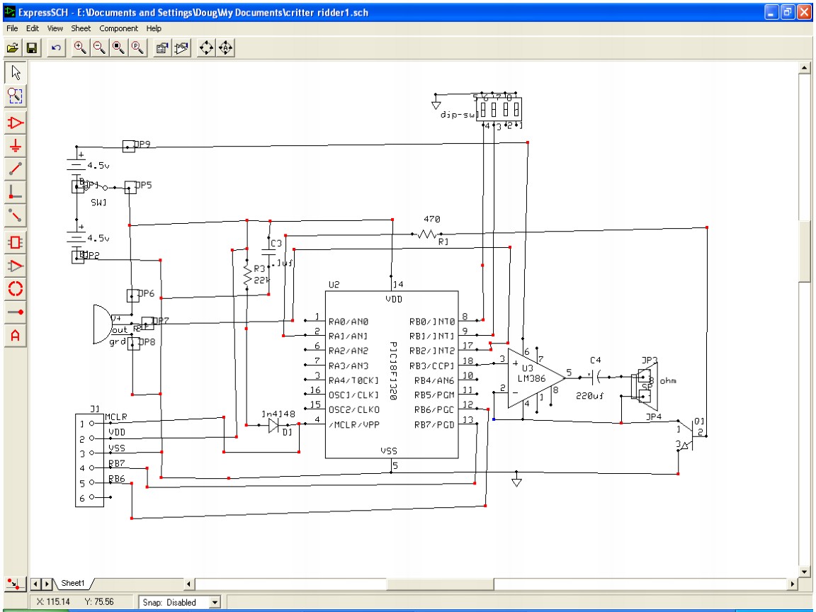

10k is find for R3 here what it said
* Turn SW6-1,2,3 OFF to when using the ICD connector (CON2)
that to program lol bill posted at the same time
When to use or not
why use the 10k vers the 22k as in the schematic.
and the diode is just to lower the voltage on mclr?? while the resistor lowers the current??
I have several 10k resistors
will insert and progra,m a chip and try the monster out.
oh need to change some code but should work with existing.just need to add a push button to the breadboard
Some parts have a wide range of suitable values. 4.7K to 47K are typical MCLR values. The diode blocks the programming voltage VPP from driving VDD.
Every one dos it there way The datasheet from pic miro tells you to use a 10 k to pull mclr up to VDD it makes your chip run right. The diode blocks Vdd from getting 12 volts when you program the chip or you would need a jumper for mclr. some chips you can get by with out it and some will drive you crazy trying to find out what you did wrong
So I always use the diode and the resistor like I showed you but a 22k will work I just use a 10k
I added battery, split batteries, removed diode and moved 2n2222NPN transistor
The moment Q1 is biased , the transistor would FAIL. Please cgeck your schematic. collector direct to Bty and Emitter direct to Gnd.
oups the battery is supposed
to be connected to pin 6 of the amp, not the transistor. Must of happened when I moved a large block of components over at one time.
THANKS I need to double check things

corrected schematic
I moved said mistake
this should work
still contemplating the split cells

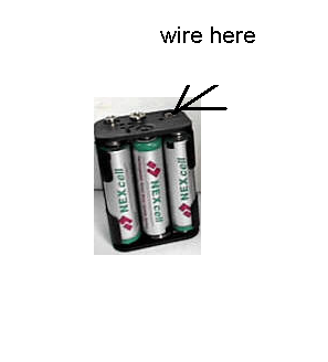

A 3 cell AAA holder = .89 cents. need 2 = $1.78
the 6 cell AAA holder is $1.38 + .05 cents for diode.
wonder if the split batteries is worth the extra 40 cents per unit?

P.S you can get better npn's then the 2n2222 and why did you change the base resistor to 470 ohms thats uses 10.417 Milliamps the 1k used 5Milliamps Oh you don't need split cells holder a 6 cell will work just as good you just solder a wire on three cells of it. **broken link removed**

I wondered about doing that=battery
looked at the data sheet of the holder and yes it is doable but the end user (the persons with all the deer running rampant eating their yard) needs to (better appearance) have a battery holder that won't become disconnected or break a wire off.
am even considering putting a plug on the battery case so the batteries can be removed much easier.

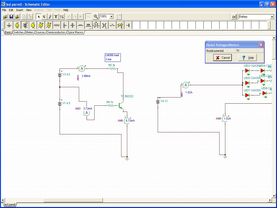

Tina sim of 3ma load=LM386
using the 470 ohm base resistor= 7.79 ma
the 1K shows 3.72ma
I assume that to verify saturation I do 2 simulations
one with the collector shorted to emitter and one without the short
if both show similar results then the transistor must be saturated??

The LM386 draws
from 3 ma min - 8 ma max
I didn't even think about actually powering the amp off the PIC if it is even doable??
the 2n2222 is maybe overkill or just a way to isolate from outside world??
This PIC thing is all new
then eliminate the one battery pak?
run the amp on 4.5 v instead of 9v?
connect ra1 directly to pin 6 of amp?
