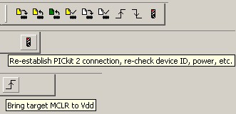

Why is it that when I use PicKit2 Ver2.61 (with Bill's Junebug) to program my 16F88 the PIC application works when downnload is complete (without me having to remove the ICSP cable)
BUT
when using MPLAB, once I've programmed the PIC (from the PicKit2 program toolbar) I have to remove the ICSP cable before the PIC starts working? It programs without any errors, but it does not seem to want to work thereafter for as long as the cable is still connected to the Junebug??

Ahh, wait, I can answer my own question ....
With reference to attached picture,
all I need to do once a download is completed, is to click on the icon, "Bring target MCLR to Vdd" and away she goes.
Nice hey?

Do you have the PK2 selected as a programmer - not debugger?
If so, go to menu programmer->settings and select the option "run after a successful program".
Ahh, Thanks Mike, that works even better!
