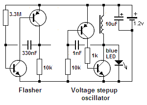

Simple circuits can be baffling:
1) I copied the voltage stepup circuit from my solar garden light and it works for about 1 minute then stops. Its frequency gets lower and lower just before it stops. I don't know why. Maybe the 1nF capacitor is bad.
2) I copied a flasher circuit from Bill Bowser's site and it doesn't oscillate. Both transistors turn on and stay on. I don't know why. Maybe it needs a 1k load.
There was a PNP transistor used as a gate with a 100k series base resistor between the circuits that I removed.

As illustrated in your circuit, the flasher circuit doesn't actually do anything so it's no surprise that the LED just stays on.

It is the very simple flasher oscillator that doesn't work.
Both transistors stay turned on.
The resistor at the base of the NPN transistor begins to turn it on.
The NPN transistor then turns on the PNP transistor a little.
Positive feedback through the capacitor from the PNP transistor turns on both transistors very hard.
When the capacitor is fully charged then there is no more strong positive feedback so the NPN transistor turns off slightly which turns off the PNP transistor a little and positive feedback through the capacitor quiickly turns off both transistors completely.
Then the capacitor charges through the base resistor until the NPN begins to turn on again.
The current gain of the transistors is so high that I think my circuit needs to have a 1k load resistor instead of the 10k so that the transistors can turn off a little when the capacitor is charged.
I'll try it in a few minutes.
I fixed my Flasher Oscillator.
I suspected that its load resistance was too high at 10k so I tried 1k and it oscillated, but not with a steady frequency. Also its duty-cycle changed.
So I connected my DVM to the base of the 1st transistor and it worked fine. I soldered a 22M resistor to ground there and it works perfectly.
