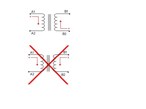

I could be wrong, but it looks to me like you have A2 and B2 swapped. Check to see that you have 1.5 volts on the collector,, and 0.7 volts on the base.

ok.. finally it works!
i solved the problem by reversing the transformer wires... i also made this diagram and i hope it can help everyone who hasn't managed to make it work.

I suggested that on my first response to this thread, perhaps you need to read the replies a bit more carefully.
yes...sorry, i overlooked you post...
I've noticed it later on when i managed to make it work...
now i think it is going to be clear for everyone!

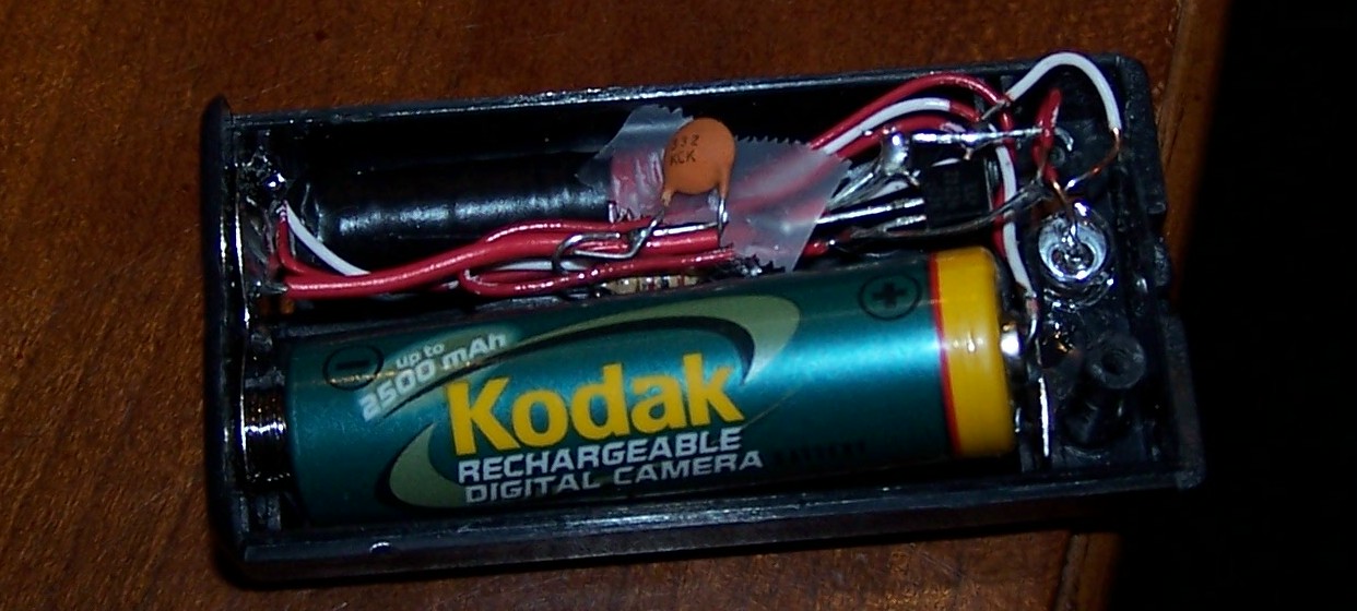

I have built at least 10 of them. My favorite one I stuffed inside a AA battery holder. It is really neat and compact.
In this picture it is a AA rechargeable, this was when I first put it together. right now it is sitting beside my laptop (brand new ) lighting up my room.
Wizz, do you mind if I put that pic on my website? I think it would look really nice.

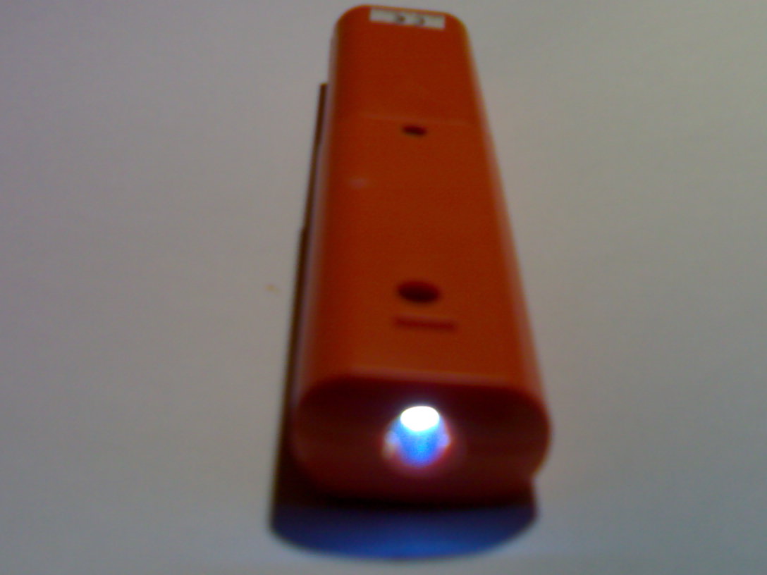

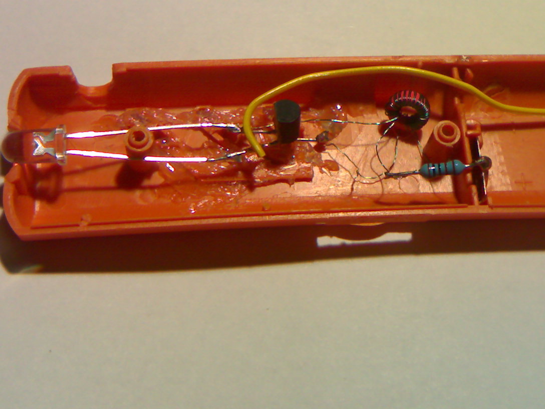

i mean step by step details so i can understand it totaly! thanks for you try though! here's mine!
P.S i forgot.... mine also has CE approval, as you can see in the second photo!
