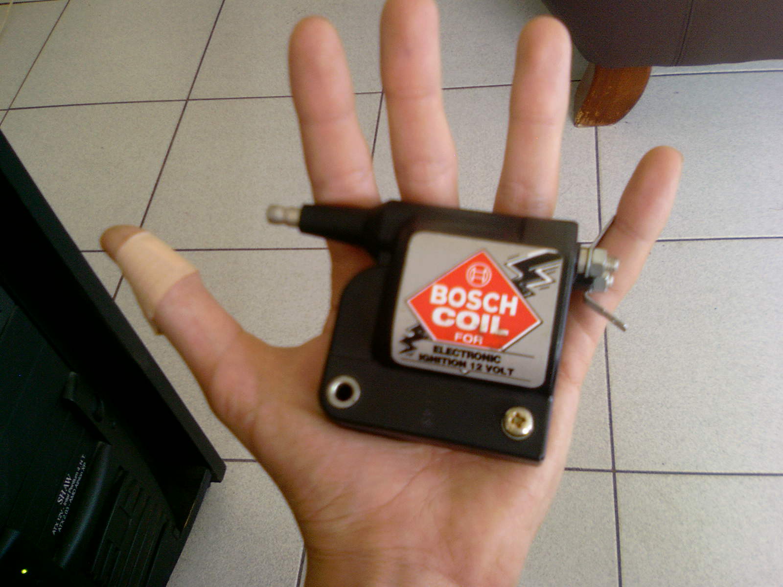

i have a bosch 716 ignition coil which i dont know what the specs for it is. But i want to know how many watts do i need for the dimmer switch?
Probably the cheapest would be fine, as there isn't much current needed.
With a 5 :mu:F capacitor, on 60 Hz 120 V the average current is only about 0.1A so you don't need a high power rating.

Just recieved the igntion coil today....alot smaller than it look liked over the internet, fits in palm. I dont know if voltages being produce from this would be enough..how would i test it?
dont worry i tested it with just a 9v dc battery and it produced a tiny spark. I measured the output voltage with a 500v digital multimeter and i got a max spike of around 1000volts. I only got a spark when i tapped the battery on and off... is this pulsed DC???
