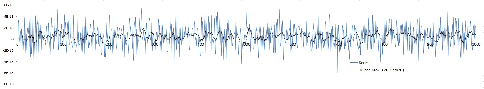

I am making a device which produces small direct current around 100 femto amp (1 fA = 1e-15 A) and am trying to measure it directly using a Keithley 6485 Picoammeter.
It is a device with two metal foils sandwiching an insulator (Alumina) foil. Very thin foils, 0.5 to 1 mm thin. I need to attach connections to the sides of the foils (0.5mm sides) and want the best solution for such small current measurements. Please suggest. I cannot however use destructive methods like soldering etc. I tried using silver based conductive glue to attach copper wire, but the set up did not work.
For shielding, I put the whole device inside a grounded aluminum box.
Other than that, I am using a coaxial cable with BNC connector to connect the device and the picoammeter.
The last time I did a measurement, I saw just noise, random noise. No signal.

Even at the fA level, electric current comes from energy conversion. What is the nature of the device you are measuring? Years ago there was an ad for a new IC (NS? LTC? BB?) with input bias current so low that it could detect an input current as low as 25 electrons per second. At these low current levels, normal surface contamination on a pc board can wipe out most signals, probably what is happening to your measurements.

At such level of current, are you sure that the interconnecting coax, the connectors and everything else is up to the task? I wouldn´t trust the isolation in the coax for example, my bet is that the leakage is way too high for such levels, and that is probably what makes you measure noise instead of a useful signal.
Professionally, I did a lot of low current measurements. You HAVE to loose the coax. Connections have to be Triax. Triax cables are about $100+ USD for 3 feet.
The connections consist of ground, guard and a center conductor. Keithley used a graphite impregnated shield to minimize current generation from flexing.
BTW, Triax come in 2 lug and 3 lug. The two lug will fit BNC's but will destroy the Triax connector.
Guard has the same potential as the inner conductor, thus leakage is minimized.
You box should be grounded. Inside your box there should be a separate plate insulated by at least Teflon. I don't know if you have to go better than that. The guard terminal is attached to the second insulated plate.

If you use substrates like glass, they have to be squeaky clean. The rinse I used was semiconductor grade trichlorofloroethane, methanol and Freon TF blown off with dry Nitrogen. Freon TF was phased out because of environmental problems. The Freon TF was a dip. I could measure an appreciable current on a piece of glass with a methanol film on them.
You can also use the coulombs mode, but you generally have to release zero check and hit zero correct shortly after. Divide by the time and you get current.
At these current, both motion (moving a wire in the earth's magnetic field), and flexing (triboelectric effect) create currents and to some extent the piezoelectric effect.

At these low levels there ought be some Seebeck (thermocouple) effect too.
