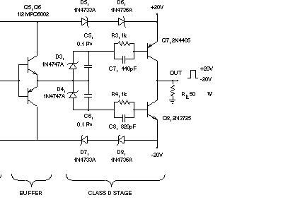

Is this a class D amplifier? If so, what is the reason?

The outputs would be driven into saturation and then off like a switch so it would be class D . Give me a nice analog O/P stage anytime.
Many high power amps are class-D today. They are small, lightweight and very powerful. If they were analog then they would waste a lot of power, get too hot and melt.
But do they give you an output which is nice to listen to. All this recent bump bump stuff which I hear coming from inside cars is ideal for digital but it's no good for music. In Class C you're biasing beyond cut-off,more efficient yes but distorted.
You're missing the point, it's NOT a linear amplifier, all it does is switch between the supply rails - at a high frequency, giving a large squarewave output. This is then passed through an LC lowpass filter that removes the HF component, leaving (in this case) nothing. In use the audio signal is used to modulate the mark/space ratio of the squarewave drive signal, giving pulses of differing widths at the output - after filtering the large HF components are removed again, leaving the modulation to feed the speaker, which is a low distortion amplified copy of the original audio.
Distortion is certainly low enough for top HiFi amps, although linear designs are probably still slightly better? - but can you hear the difference between 0.01% and 0.005% distortion?.
Well, its the OUTPUT stage of a class-D amp. Its missing a lot, such as the heart of the device, which is a PWM circuit (triangle wave + comparator).

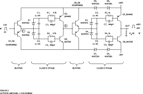

Here is the whole circuit, If it is a class D amplifier why it seems it is not perfect?!

It is not a complete class-D amplifier. It is just a pulse amplifier.
It doesn't have an audio input stage.
It doesn't have an ultrasonic oscillator.
It doesn't have an audio to Pulse-Width-Modulation converter.
It doesn't have a lowpass filter to feed the speaker.
It doesn't have negative feedback.
Doesn't have much at all!.
I was once given the job of designing a sonar transmitter amplifier. I started out with a class D design (class D was not known in those days, but that is what it was). Another engineer told me that it would not meet the intermodulation requirements, but since I was already building a breadboard, I tested it. In a two tone test, the sum and difference frequencies were only 6 dB down, which is another indication that the human ear is very tolerant of distortion.
