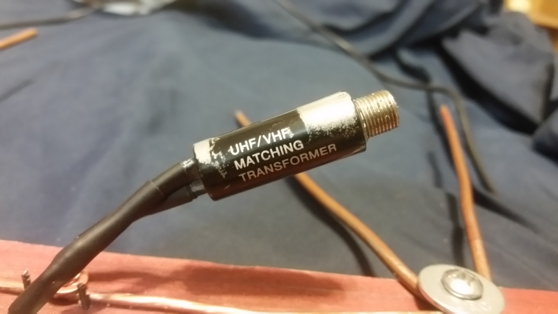

I am trying to diagnose my FM radio antenna.
Is this a balun?
Thanks.
118553
Sorry, my crystal ball is in repair. So short of measuring the thing, the only possible answer hovers somewhere between possibly and likely.
I can measure with your help.
I found out there are 2 types.
75 -> 300 and 300 - 75 ohms.
The one I need would need to work for a FM antenna.
75 ohms is definitely on the side of the coax, and 300 is on the side of the antenna. So i guess it should work. but saying where did you get it and what was its purpose was would shed some more light onto the problem.

You could say splitting hairs that its a unun.
Unbalanced in at 300 ohm, and unbalanced out at 75 ohm.
Being a transformer it'd work either way.

Why do you imagine it's unbalanced 300 ohms?, it would be pretty unusual - more likely it's a balun - particularly in the USA where they commonly used balanced 300 ohm feeders, where Europe never did.

it is a 75 ohm to 300 ohm balun. they are used for connecting an older TV set to CATV, or for connecting a high impedance antenna (a folded dipole, either by itself, or as part of a yagi array) to 75 ohm coax cable. these baluns are so ubiquitous that you can often buy bags of them.
these baluns work between about 50Mhz to 600Mhz. the FM broadcast band is well within that range.

I took my balun apart.
They used 100 gauge wire.
The last one I came across with an F connector was 300 to 75 ohm.
