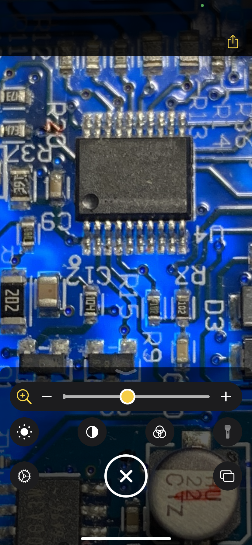

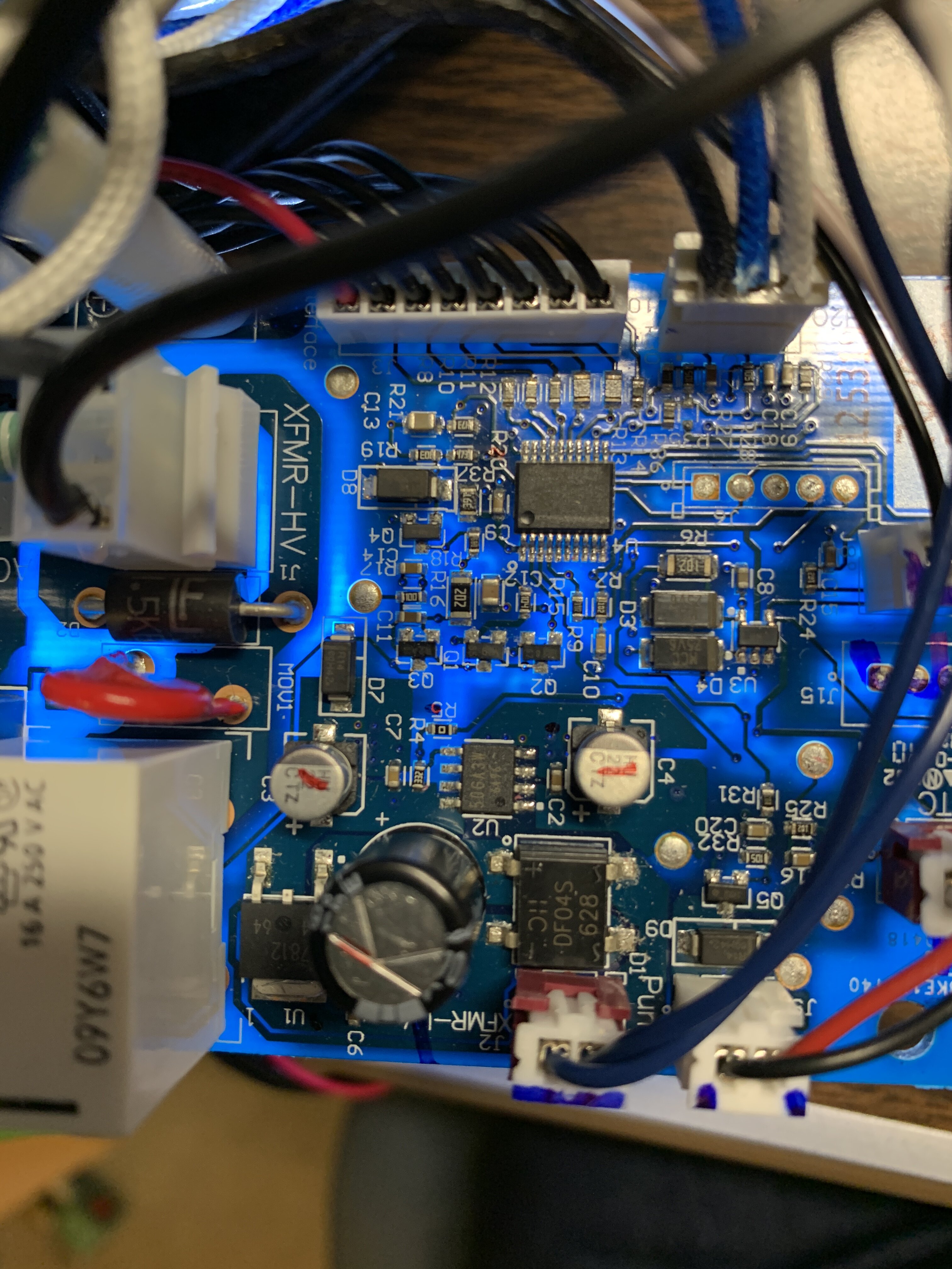

Here are a couple pictures
Looks like it uses the internal oscillator (no crystal on pins 2 & 3) and no ICSP connector so not much you can do.

Its a nice PCB. I wish there was a way to get a schematic and the source code for the PIC. haha
ICSP connector
Now that you mention that... the round pads to the right of the PIC.... do you suppose that is what those would have been for? One is tied into MCLR... didn't trace the others. I assumed it was for a connector that this model doesn't use but maybe it was to program the controller?
That was my thought, looking at the photos. Only five pins are used on ISCP / ICD connectors.

If it is (and it looks about right) then the connections should be Vpp (MCLR), 5V, GND, Data (pin 19), Clock (pin 18). Do you have a pickit at all?
I would say it absolutely certainly is, it's a fairly standard way of doing it.

Those look like they are wired so that the processor can be programmed with a PICkit. I would certainly try connecting to those and reading the PIC. It will probably be read-protected but it is worth a try.
