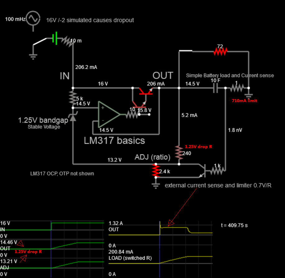

https://goo.gl/GGUfna
Try this, simple with some tricks to learn but works.
