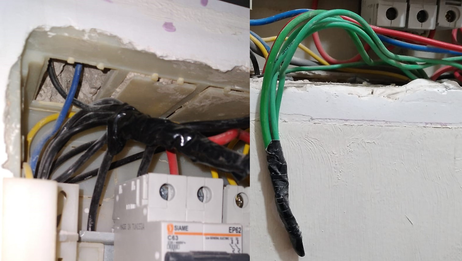

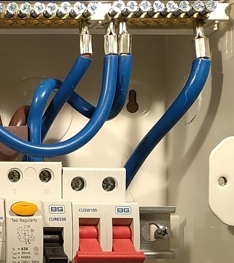

Hi All,
Is there any difference in these connections in home electrical wiring systems, whether it is for the hot line, the neutral line or the Earth line?
Twisting the wires together
Or Using busbar
Regards
Using busbars is much more reliable and safer. In every country I've lived in busbars are compulsory.

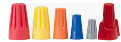

Here twisting wires together is allowed if a twist wire nut is used to connect them together (any connection).
Electrical tape by itself is not allowed.
Yes, a lot - possibly life or death. A simple twisted joint can corrode, the resistance increases and it starts to get hot or arc, possibly causing a fire.

Also, Having used the N.A. style, which by the way, are quite a bit different from the old Scru-it, the N.A. version has a metal thread-like interior and has been used for many decades here.
The old UK version was just all porcelain.
I was leery at first, but over a few decades found they appear to do the job very well.
I never use wire-nuts today.
