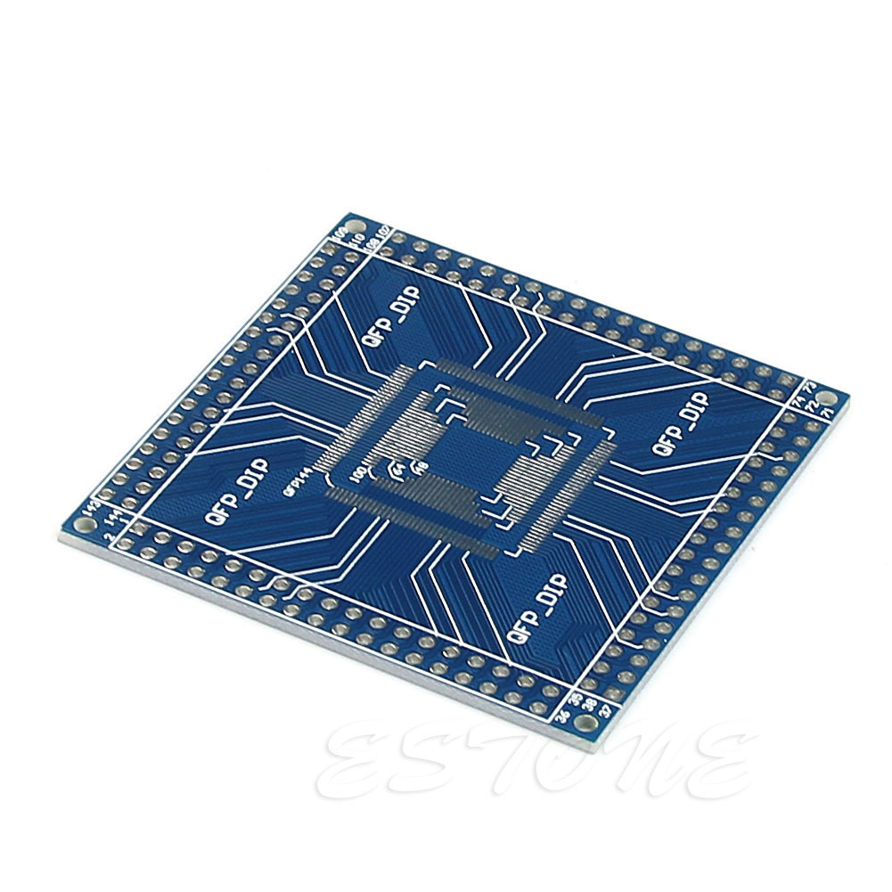

Does anyone know the search term or supplier for a connector designed to solder on to a 32-TQFP pad and break out the connections? I know there are adaptor boards to put a surface mount component or connector into a DIP size through hole socket, but I need the inverse of that. At this point, I don't care if it gives me wires, pins, or connectors. I just need to replace a small MCU with an external control for a testing application. This seems like a problem others may have faced enough that an adapter part may exist. If not I can probably make a tiny PCB to solder onto the pad and bring the pins to a connector.
I have just done a search on eBay using just the term '32-TQFP pcb'. That seems to be what I think you're after.
I easily find the kind to break out a surface mount chip, I have a lot of them actually. Like the one pictured below. But what I'm talking about is something that does the opposite. I have a board with a surface mount chip and I need to attach an external device in its place. So I need something that solders onto this type of SMT pad and brings out a connector, pins, or wire. If you did find something like that please share the link.

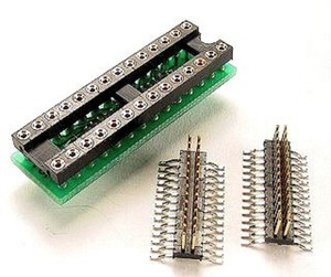

That's pretty much what I'm looking for! I could see making a fairly simple PCB to do it if I can't find a similar adaptor in TQFP size.
That did give me the idea to try searching for SMT connectors and see if there are any that happen to have a square 32 pin base of the right size. I'll see what I find. Also, it may be a bit more trouble but maybe I could just use 4 connectors with 8 inline pins and the right pitch.

Have you looked at Ironwood?
It looks like they have exactly what I need here. Since I may need to make a lot of them it could be worth the price even if they're kind of expensive. I wrote to them for a quote.
Once I got the term "Surface Mount Emulator Bases" from them I found a few more companies that make them
like this: **broken link removed**
This one looks fairly elaborate.
