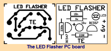

I am currently studying some of the material at talkingelectronics.com and came across this circuit:
118679
(http://www.talkingelectronics.com/projects/FlasherCircuits/Page83FlasherCircuitsP1.html)
I am not an expert in electronics, however, I have the feeling that the E-Cap (10u) is inserted the wrong way (+ and - should be swapped). Is someone willing to enlighten me? ;)
TIA,
Alexander
The LHS (-ve) is connected to the base of the NPN, so can't go higher than +0.7V, the RHS (+ve) is connected to the collector of the PNP, so can got to +6V minus the voltage drop of the LED, so about +4V, so it's the right way round. It's basically a variation on a multivibrator.

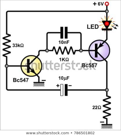

I just made some google search and found a number of circuits which look like this:
118680
Here, the E-cap is just the other way around. I am bit puzzled now, at least. :confused:
There's lot's of incorrect circuits on the Internet, and that's another example of one - presumably someone (like yourself) saw the original circuit and decided it was the wrong way round.

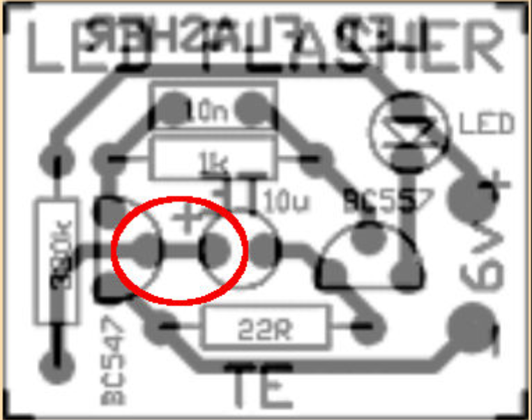

I had a closer look at the PCB layout:
118683
If I am not totally wrong, the anode (+) of the E-cap is connected to B of the NPN and not the cathode. This puzzles me even more now. :(
No, it's clearly connected to the collector, and the right way round - the base is the middle leg in civilised pinouts :D
To the collector of WHICH transistor?? I thought (-) should be connected to B of NPN and (+) should go to C of PNP? Look at the side where the tracks are and then you'll see how the connections are done.
Sorry, I was obviously confused flipping the two sides together in my head :D
But as I've said all along, the positive goes to the collector of the PNP, as that's (by far) the most positive side.
There's no point keep posting faulty circuits and layouts you find on line, the +ve should go to the most positive point, your first one was correct.
