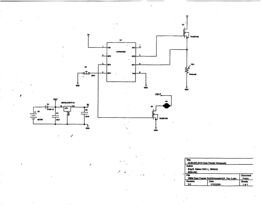

hey guys im a newbie here,
completly new to pics and i learned this code this week:D
well im in this assignment to write a code for the pic 12F509
this instruction here is gonna be the very first set of instructions the pic is gonna perform
does it usually just start like this or am i missing something???
i have a feeling "org0" should be at the very first line???
LOOP:
IF GP3 = 1 THEN   'Switch pin
HIGH GP3   'Motor pin
PAUSE 6000
LOW GP3
ELSE
LOW GP3
ENDIF
GOTO LOOP
Any suggestions or mod?
THANKS

It looks right except the motor pin is GP4. Does the basic you are using automatically set the pin to output when you use the LOW/HIGH command? Which compiler are you using?

hey mike
hmm i never thought about the setting of the pin.
i bought a pickit 2 and im using mplab
Not sure about this BUT I think gp3 is master clear and needs a pull up resistor,
so the button should take it low. and in the fuses you would need to turn _MCLRE_OFF
