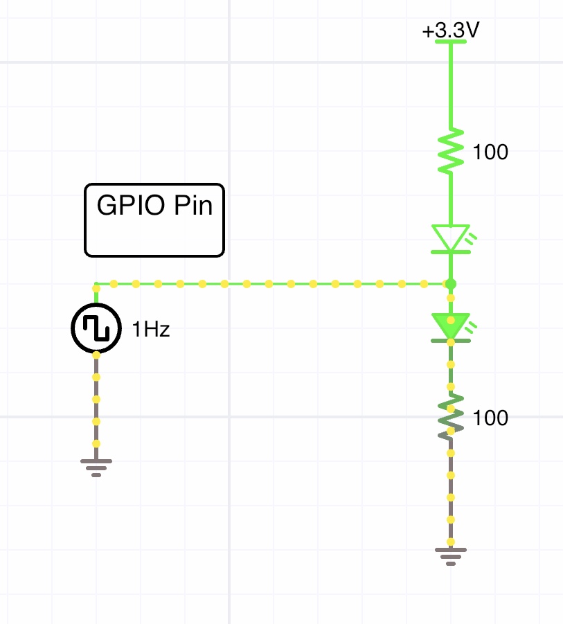

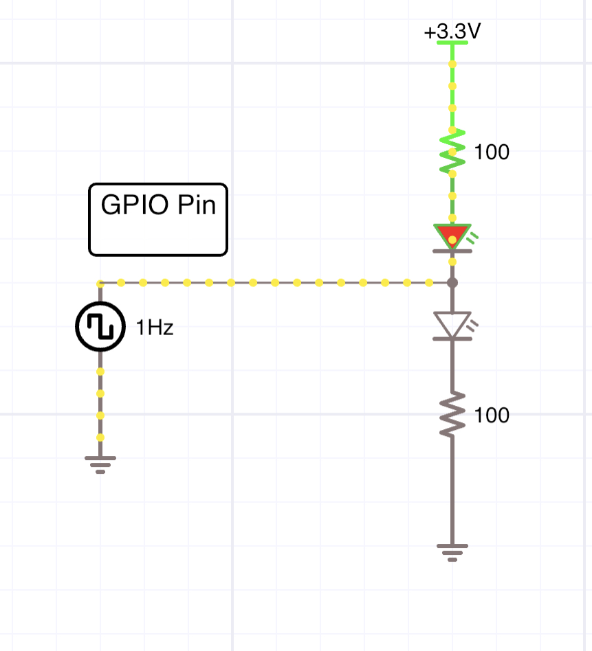

you only need one GPIO pin for red and green.
also, look up "charlieplexing" to see how few pins you need for many LED combinations.
GPIO high output
GPIO output Low
GPIO high output
GPIO output Low
I couldnt find those leds with only 1 GPIO pin, red/green ones. If u know where to find them, please post a link. But looking at the schemes i think i understand. If you pull GPIO low, it will act as ground and led will be powered by 3.3V pin. If you put the GPIO high .. it will serve as 3.3V pin and ground as ground. Which would work great in my case. Btw .. in this case its either green or red but impossible to turn both off or on right ? Nevertheless, this information will help me since i often just need either red or green.

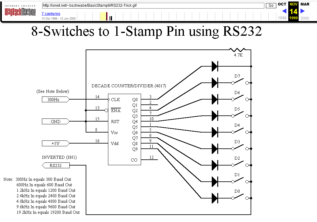

This is something I did ages ago, but it might be applicable here. It's simmilar to how game controllers in the 80's would send button information back to the game consol. In your case, each side of the cube emits a different serial pattern based around the circuit below.. The 4017 core would be the same (One per cube), but the diode pattern would be different for each side.

Yes, you need two LEDs, one green, one red. One will be on when output Low, other when output High. You can turn both off if you use some type of charlieplex - source or sink with another GPIO. Many options.
The 4017 idea is a possibility - use one such circuit and feed the "start" bit plus one or more other bits to each connection, using different diode combinations for each output.
Or, forget RS232 type encoding and have the first two outputs always connected (via diodes) to give a double width pulse, next alway open and one or more other non adjacent outputs combined for the unique code.
That means you can wait for the long pulse for synchronisation, then read the other bit(s) and decode from the relative time offsets.
The steps would be multiples of half the sync pulse duration so it can be done in software without needing precise clock speeds in each "sender".
