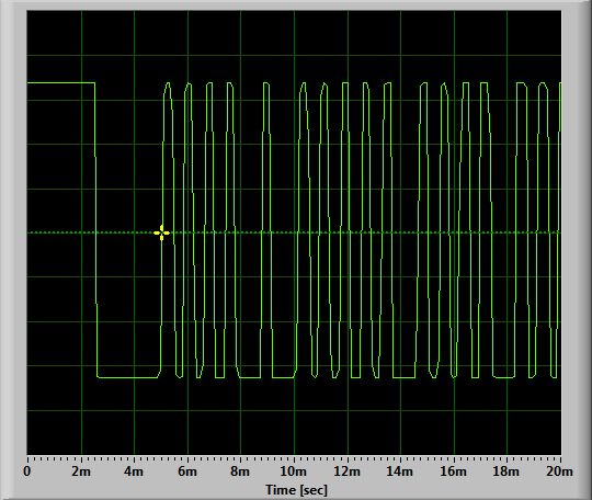

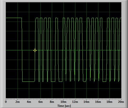

guys plzzzz we need help here, we are now comparing between the remote control for the air-con and our transmitter on the same receiver and we got phase difference, but the pattern is almost the same only the phase. we tried to ON and OFF the air-con it WORKS but not always, means from 10 times we tried only 3 times works...
i will post the photo from the oscilloscope hope anyone can help us.....
thanx in advance
hint: pic1= remote control
pic2= out transmitter
