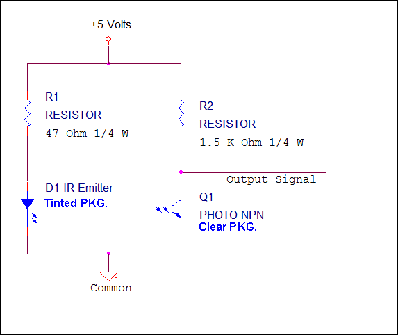

Ok ron I was wondering what happened to you. I got a pair my self and tried using them together with another NPN transistor and to no avail. There I didn't get it to give me any response. I tried pointing the led at the emmitor and the connecting the base of a 2n2222 transistor to its collector and checking the output at the other transistors collector. Got no type of response. When breaking the line of sight between detector and emmitor I got no response at the output what you think.
OK, I bread boarded real quick a little setup and am attaching the drawing.
This was just the simple Radio Shack part number 276-142 IR Emitter and Detector pair. The specifications are on the package.

I limited the emitter current with R1. It should be below 100 mA with the 47 Ohm 1/4 watt resistor I used so well below the 150 mA maximum but adequate. When you start with things like this it is wise to keep things below maximum ratings.
The IR detector is an NPN Photo Transistor so you don't need another transistor in there. Think of the base as where it receives IR light. That leaves the emitter which is tied to common and the collector which is tied to 5 Volts through a 1.5 K Ohm 1/4 watt resistor to limit the collector current.
Note: You need to limit the current through your emitter and detector or you will toast your components!
I slipped a piece of drinking straw over each, the emitter and detector to help shield against stray light. About an inch long or so. Not the best shield but adequate for this test. I simply aimed them at each other across the bread board.
No light obstruction I got .1 Volts at the line marked Output Signal and when I blocked the light I got 4.5 Volts on the Output Signal line. Those are fine TTL levels for driving the gates.
If you put it together exactly as I drew it it should work fine. I did notice in my original drawing I had the detectors polarity reversed. The cathode sides should have been to common. Also, the original drawing used IR Photo Diodes and not photo transistors.
Questions?
Ron

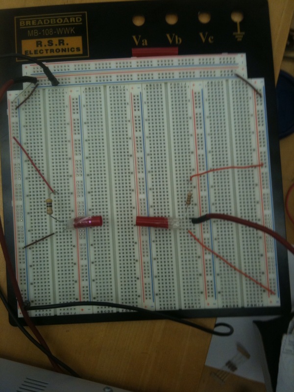

Ok ron. I connected the IR pair just like the schematic instructed. Only difference is I used 4.5 v instead of five and when I ran it it only have me values of 3.3 and 4.4 wilthout and with obstructions respectively. Been at it for the last hour. Any suggestions. Also I used pieces of straw over the leds as recommended by you.
The fact that you now see change tells us something is working. The fact that with the unobstructed IR path you see such a high level tells us that for some reason the photo transistor (receiver) isn't seeing much light.
I only used the short piece of drinking straw as a shield of sorts so you may want to mess with that. Something else you can try is if you have an IR TV remote point it at the receiver and push a few buttons and see if the thing reacts. Keep in mind any IR remote device will transmit pulses so it may look weird.
Based on your last post either the transmitter (emitter) isn't putting much out or the receiver isn't seeing it. I also don't know what the previous setup you tried may have done to the receiver or transmitter.
Ron
hi ron we tried this today and to no avail.. here is a picture of our setup with straws tell me what you think thanks
It looks pretty much like what I threw together. Maybe it is just me but I don't see one power line to the receiver? I also just for the heck of it did aim the TV remote at it and got a reaction. I din't bother to connect a scope to see the pulse trains from the remote. I can't understand why it won't work for you if it is exactly like the drawing I did. There is so little to this thing. Weird.
Ron
ok well are you sure the resistance at the emitter is 1.5k cause that would limit the current to about 4 miliamps. was just checking.
