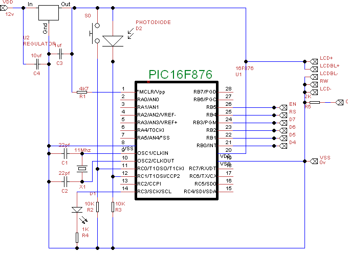

Heres my circuit.
D1 is just an LED which I use in the code to display what the IR diode sees (RC3=RC1)
D2 is a phototransistor (my software only has a photodiode symbol) salvaged from a mouse wheel
U2 = 7805
Also connections for a alphanumeric LCD for debugging.
As you can see there is nothing done to the IR signal hence the low gain.

Not only there is not an amplifier but the photo-transistor is an emitter-follower that doesn't have any gain.
If the photo-transistor has its emitter grounded and a collector resistor (try 100k) then it would have a gain of about 100.
I have to confess when I first read this it went right over my head, but in the true spirit of RTFM. I did some reading and then thought I understood, so I rewired the IRtransistor as such 5v to 2x50k resistors to IRtransistor to ground. Then taking the PIC feed between resistor and IRtransistor.
Alas - nothing, couldn't get the PIC to go high when incontact with IR.
Have I understood you correctly? or have i wired some up wrong?
You don't know what you are doing.
You forgot to attach a schematic so I don't know what you are doing.
Connect the photo-transistor like this. The output to the PIC is high without IR and goes low when IR or light is received.

I have interpreted your comments correctly and its wired correctly as i described it. I now fear my salvaged part is not all it should be I shall pruchase a new photo transistor and try later.
thanks for the help.
If you know the part number of the photo-transistor then look up its datasheet to see which pin is which.
