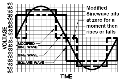

I have faced new problem on my car inverter.
I have my lap top charger 230 to 18V , I can use it with out any problem at home power outlet or in another car inverter outlet.
But when I plug it into me car inverter outlet , I cannot use mouse ( not moving), but can charge the battery, then I have to unplug the inverter to use the mouse to work my laptop.
How inverer affect to the function of my laptop.
Is there any EMW interfearence generated by inverter.
What is the frequence or power cycle of inverter ( 50, 60 or something else)
Much appreciate your help.
Please let me know if my question is not clear, i will try to give more detais as much as I can
we don't know if you have a good inverter or a cheap inverter that has poor performance.
The mains electricity is low frequency sine-waves. Low frequency sine-waves do not cause interference. A good inverter makes sine-waves.
But a cheap inverter makes square-waves that are full of interference.

I belive it is a cheeper one written on it as "modified sinewave", I do not know it means anything or just a trade name.
A "modified sine-wave" is really a modified square-wave with two steps in it.
The peak voltage of a square-wave is much lower than the peak voltage of a sine-wave so electronic products might not work but the average voltages are the same so heaters and incandescent lights work fine.
The peak voltage of a modified sine-wave and the average voltage are almost the same as a sine-wave so some electronic products work if they do not care about the harmonics.
