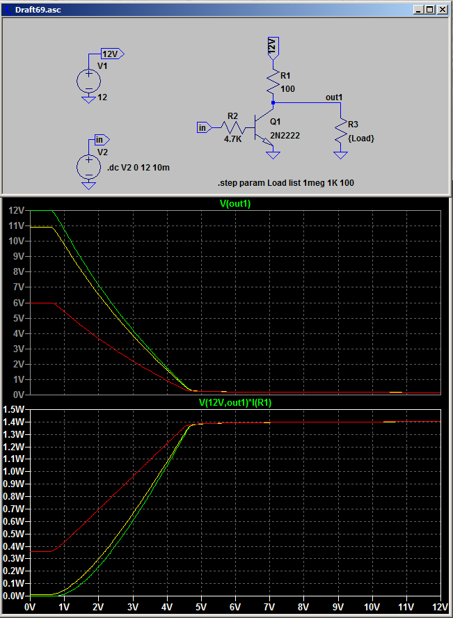

Here is a picture that has serious problems. V(out1) vs V(in) at three different values of load resistance.
Note the skewed threshold.
Note the output voltage when the load is 100Ω.
Note the power dissipation in R1.

The load (in my case here) is high impedance.

Ah, I see. THat clears things up.
