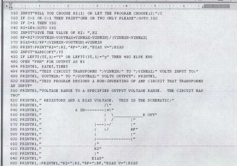

This is the type of circuit you want. If the gain is less than one, you will need an input attenuator.
my god, thats old style printing.
Is that a copy from the 1980's?
So if i put in a +5 volt waveform it will output -12 ?
Do i just experiment with the resistor values?
How do i get different transform ranges?
Inputs are +6 or +8 but the outputs are -12 or -10

yes u can
for different transforms u ned to adjust the bias and resistor values
(remember the op-amp shld be dual powered).
so its the Ratios of the resistor valuse that makes the difference?
From using different Ratios i can get Negative DC offset?
