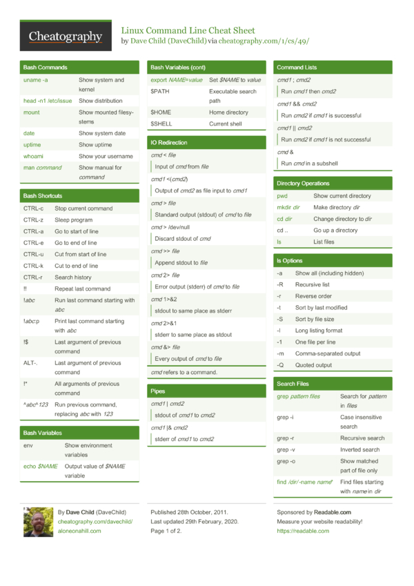

If you look for linux command cheat sheet there are many, eg.
