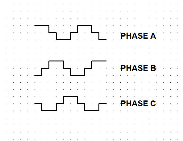

Pilko has a good point. If you look at a normal digital 3-phase signal the phases sequentially alternate between high and low (see attached). Thus you do not necessarily need to disable one phase to generate a 3-phase signal and a rotating field for the motor.
Looking at Carl's attached image above, at about the 1ms mark, the top two coils will both have current flowing into them and out of the bottom coil. Similarly, at the 6ms mark, current will into the 3rd coil and out of the top two.
So it is expected to get overlap when current is flowing into or out of two coils simultaneously?
It's a Six Step system, and the waveform looks like this:-

Mosfet switching sequence:-
Phase A Hi \ Hi \ Off \ Lo \ Lo \ Off
Phase B Lo \ Off \ Hi \ Hi \ Off \ Lo
Phase C Off \ Lo \ Lo \ Off \ Hi \ Hi

Right, I understand the phasing sequence. My question relates to how you turn "off" one of the MOSFETs using an L6384 driver. If I could individually control each MOSFET, that would be trivial. But the L6384 half-bridge drivers do not allow for individual control. Using the circuit in the app note I linked to above, there does not seem to be a way to do so.
However, the circuit could achieve the phasing sequence that Carl attached in post #11. But then all three coils would always have current running through them in all 6 steps of the sequence. Either into 2 coils and out of 1, or into 1 and out of 2. If that's desirable, then we're good to go. But it's contrary to the theory that I've learned about 3-phase motor control.
And just to further clarify, because I think this is the source of confusion: The high and low-side drivers on the L6384 are always inverse of each other. So if I, for example, desire to turn off the low-side MOSFET of the half-bridge, the driver will automatically turn on the high-side MOSFET. And vica versa. The only way to turn off both MOSFETs on the half-bridge is deactivate the entire chip via the SD/DT pin. But the circuit in the application note does not allow for individual control the SD/DT pins. They're either all on or all off together.

Step 1--- Mos 1 and 4 on
What are the states of MOSFETs 5 and 6 in Step 1 using an L6384?
I've used my digital sequence to drive a 3-phase AC motor. The main problem is that the induced current harmonics from the square-wave do not contribute to the motor power but create an additional I²R power loss in the motor windings. These losses do not occur when driving it with a sine wave.
I figured that by appropriate switching between Shutdown and Deadtime modes, the six-step timing sequence could be achieved. I think now I was asking too much of the chip. I hope I havn't wasted too much of your time.
