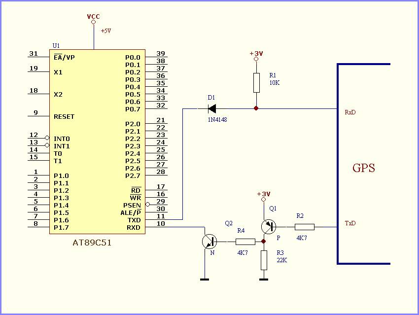

You now have a problem. The min operating supply voltage of AT89C51 is +4V but the max voltage input of your GPS module signal pin is +3V.
You cannot simply connect the interface signals together as the +5V 89C51 signal exceed the max input voltageof the GPS microprocessor.
So you need another interface between the two for 5V<-->3V translation.
I have no idea at the moment of how to translate the level short of using transistors. Perhaps others can help in this respect.

5V down to three volts can be done with either a two resistor attenuator, or a single resistor - IF the 3V chip has protection diodes on it's input, or you could add external diodes?. The other way, 3V to 5V, you should be able to simply connect the pins directly together - a 5V chip should be able to accept a 3V logic input (PIC's certainly can!).

Hi Julia,
Please wait until others have commented and checked the following circuit. Others might have better solution than this simple design.

eblc1388 said:
Hi Julia,
'Simple'? - two transistors, three resistors, and a diode, more than required - not what I'd call 'simple' :lol:
Although I did find the use of the blocking diode and pullup resistor quite interesting! - assuming the GPS unit has protection diodes (as he says) totally unnecessary though.
at first , i would like to thank you so EBLC , you did a great efforts , i appreciate that, but as Nigel says , this isn't simple beside i can't feel it's right !!
I was going to mirror the bottom circuit for the 89C51 TXD signal also and the circuit would ends up using 4 transistors.
But now it seems there is no point in doing so. :(
