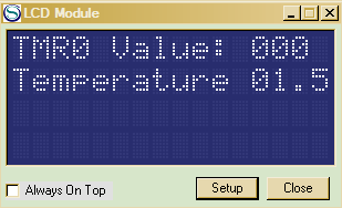

Hi , i have problem with my LM35 for not sure for the output and nothing display either wht wrong my code anyways

One of the problems is that the code was written for a 16F84 and you are using a 16F877A.
The CBLOCK is starting at 0x0C, which is OK for a 16F84 but not a 16F877A, it should be 0x020 as GP reg start address.
You must change the code to suit a 16F877A.
EDIT:
With a 16F84A and a 32kHz xtal the program runs OK in Oshonsoft Sim
