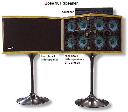

Bose made a compact but powerful speaker many years ago. It had 1 little speaker facing forward and 8 other little speakers all around. I think the speakers were only 4.5 inches in diameter.
The speaker produced no bass and no treble so it came with an equalizer that boosted the lows and highs and its response curve looked like a happy face.
I don't like the sound of a speaker that has its high frequencies modulated by its low frequencies. Separate tweeter and woofer sound much better.
