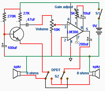

Here is a switched-speaker intercom that is a bit different. The input amplifier is common-base, which has a low input impedance that mates up well to a speaker's low output impedance, and gets you some of that there damping stuff.

View attachment 117451 View attachment 117452

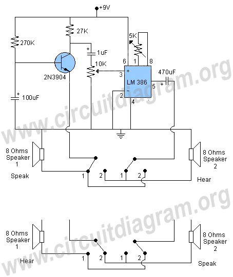

So, in this circuit, the second station is nothing but two speakers and a DPDT switch? Or does the second station include a complete copy of the circuit in the first station? Each station has a "hear" and a "speak" speaker?
The second station is nothing but one speaker. No switch, no amp. A single preamp and power amp service both stations. This is a classic "half-duplex" arrangement. Information over the wires goes in one direction only at a time. Most intercoms are like this, one amp doing double duty.
The drawing on the right is a re-work of the one on the left, with different component values. The extra part at the bottom shows the switch in the other position; it does not mean there are two switches.
ak
So station two is normally in speak mode and station one is normally in hear mode? Station 2 person just talks to signal person at station 1 to start a conversation? Person at station 1 has to flip switch to start a conversation?
As with most intercoms, one side controls both sides of the conversation. Which is which depends on how the switch is wired. Usually, the "remote" station is as simple as possible, just a speaker and maybe a call button. At the OSU airport field gate intercom, the remote stating at the gate rests in talk mode, and the master station inside is push-to-talk.

Now that I compare this to the circuit I was originally looking at, this is much simpler. Both intercoms are half duplex anyway, so it doesn’t matter who has the “push to talk” switch. If I am going to build a complicated circuit I should build audioguru’s full duplex, hands-free circuit. ... mesages crossed!
There are two problems with this circuit. 1) Since there is only one amplifier, one of the microphone signals has to travel the distance in from the remote station at millivolt microphone signal levels and at a high impedance. This is the worst possible combination for noise pickup. 2) because there is only one switch, both speakers are on all the time. Whenever you speak into the local mic, that audio comes out of the local speaker at full volume. This is the worst possible configuration for preventing acoustic feedback (howl-around). I've seen this circuit before; it is one of the few I do *not* keep in my library.
No, it isn't. As you can clearly see on the schematic, the two stations are connected by two wires, a bidirectional signal line and GND. This is a variation of the circuits in #2 and #16.

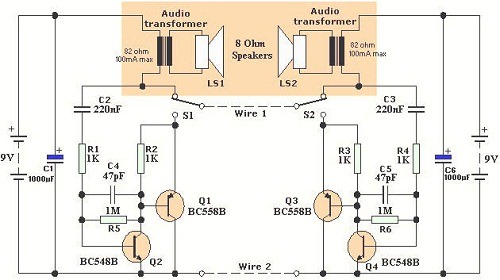

There is an alternate version out there with a small audio output transformer between the output transistor and the speaker for better impedance matching.
Note for this sch, post #2, and others - When the intercom is not being used, both batteries are connected in direct parallel through the speakers. Not good. Better to add a Shottkey diode between each battery and its bulk filter capacitor.
ak
AnalogKid, is it that the two batteries being connected in parallel through the speaker is bad for the speakers or bad for the batteries?
Concerning adding the two Schottky diodes, should I add them like this?
