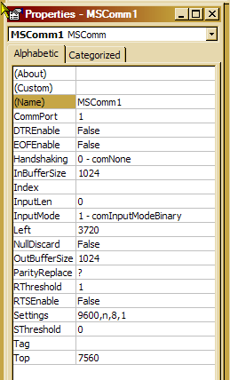

hi Lloyd.
This is a subr I use in VB5.
You could drop off the Errmsg control if not required.
Set up the Commport to suit.

I see, I used most of your code and placed it on the oncomm event. Thank you Wilksey.
