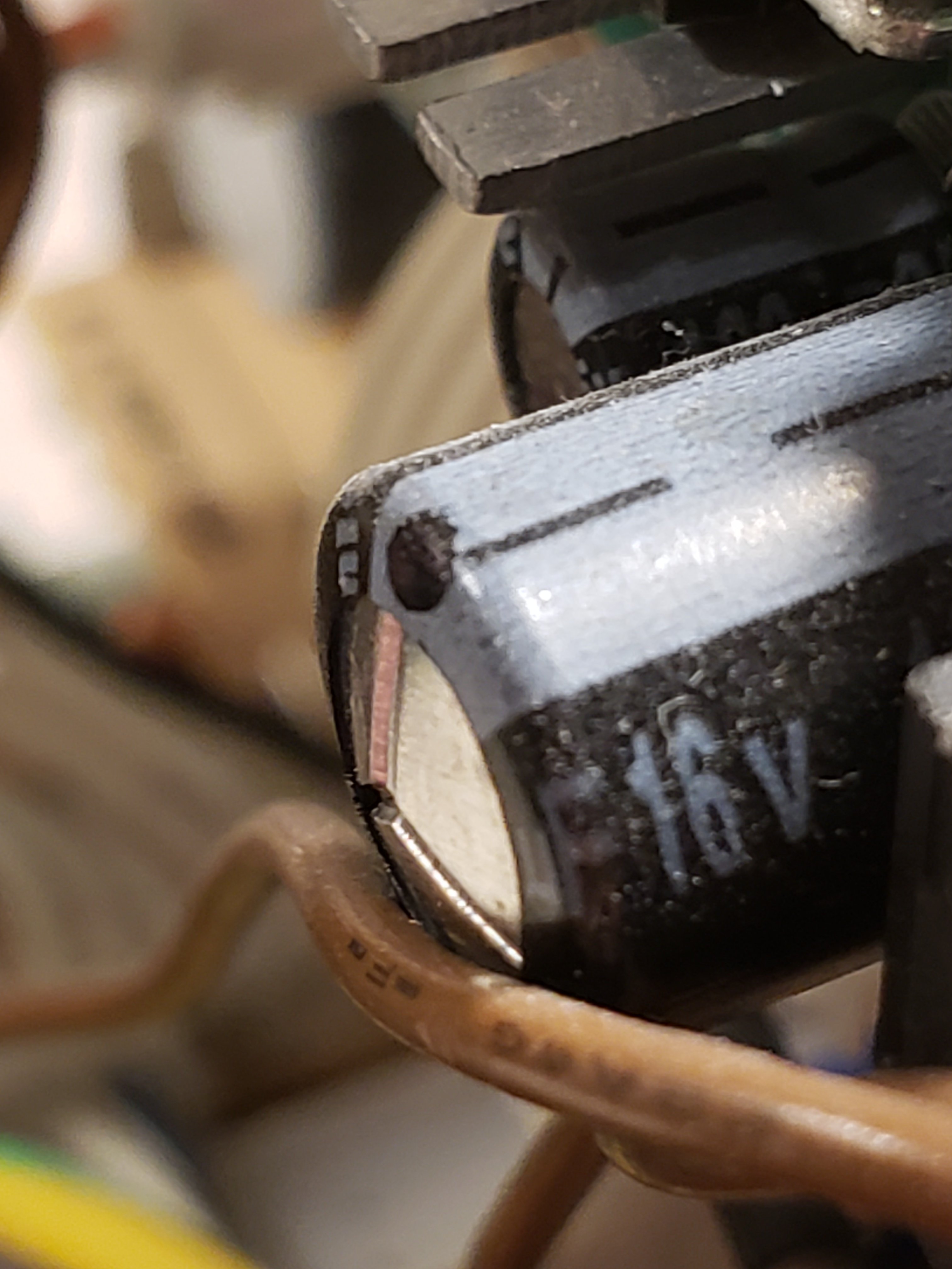

Must be a meter problem. I turned my attention to the meter. On the back of the meter, there's a small board with two 5 volt supplies, and a very bulging electrolytic cap. I think the problem has been located!
These two 5 volt supplies are fed by separate windings from the power transformer. I suspect that the metering circuits for voltage and current are completely separate, thus the need for isolated 5 volt supplies.
This cap is on the output of a 7805 regulator. 1000uF at 16 volts. I have a few caps of that rating, but the lead spacing is too small. The 1000uF at 25v caps I had were a perfect fit. I replaced the caps on both supplies and I was back in business. Steady meter readings at the correct voltage.
