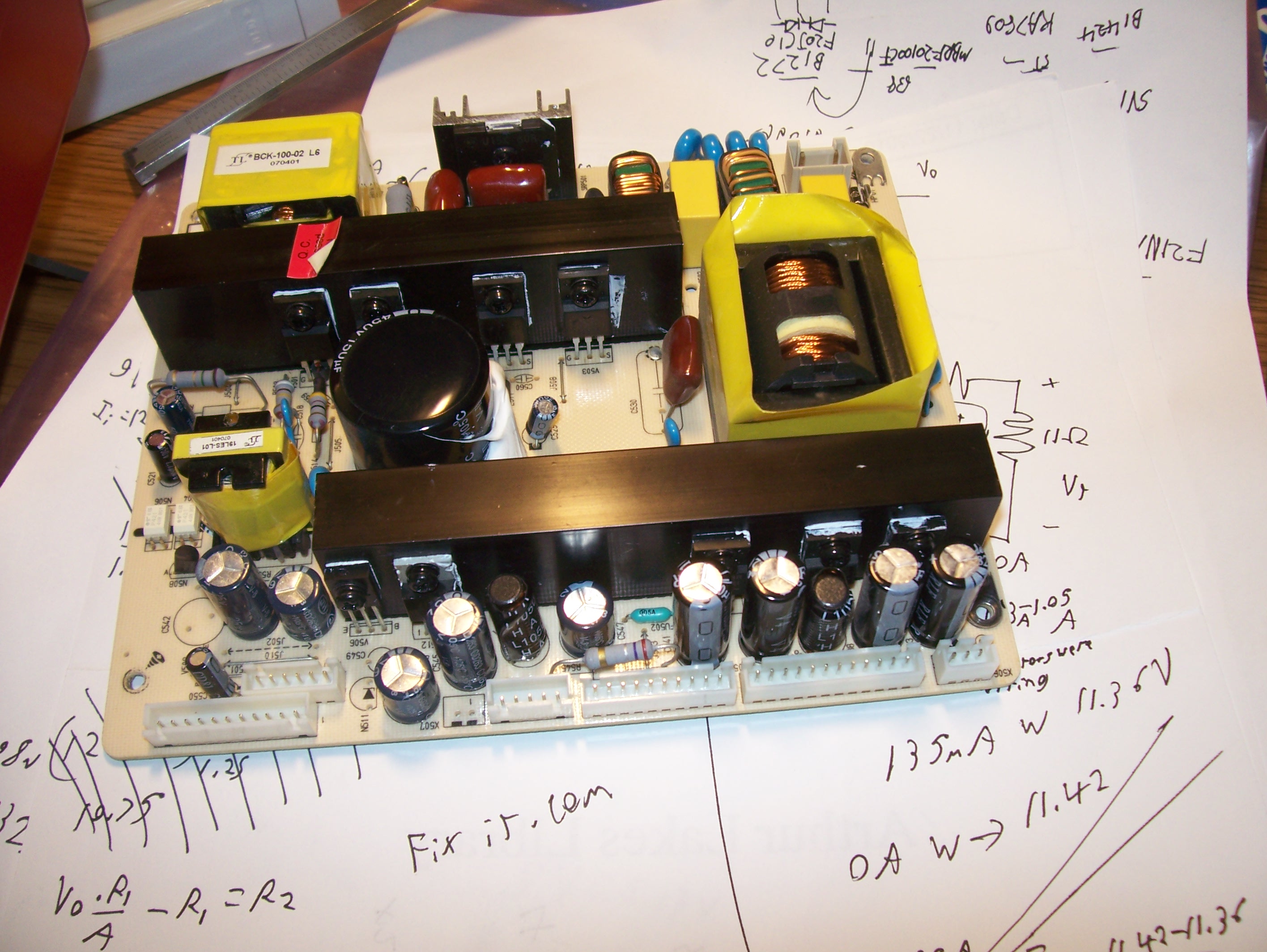

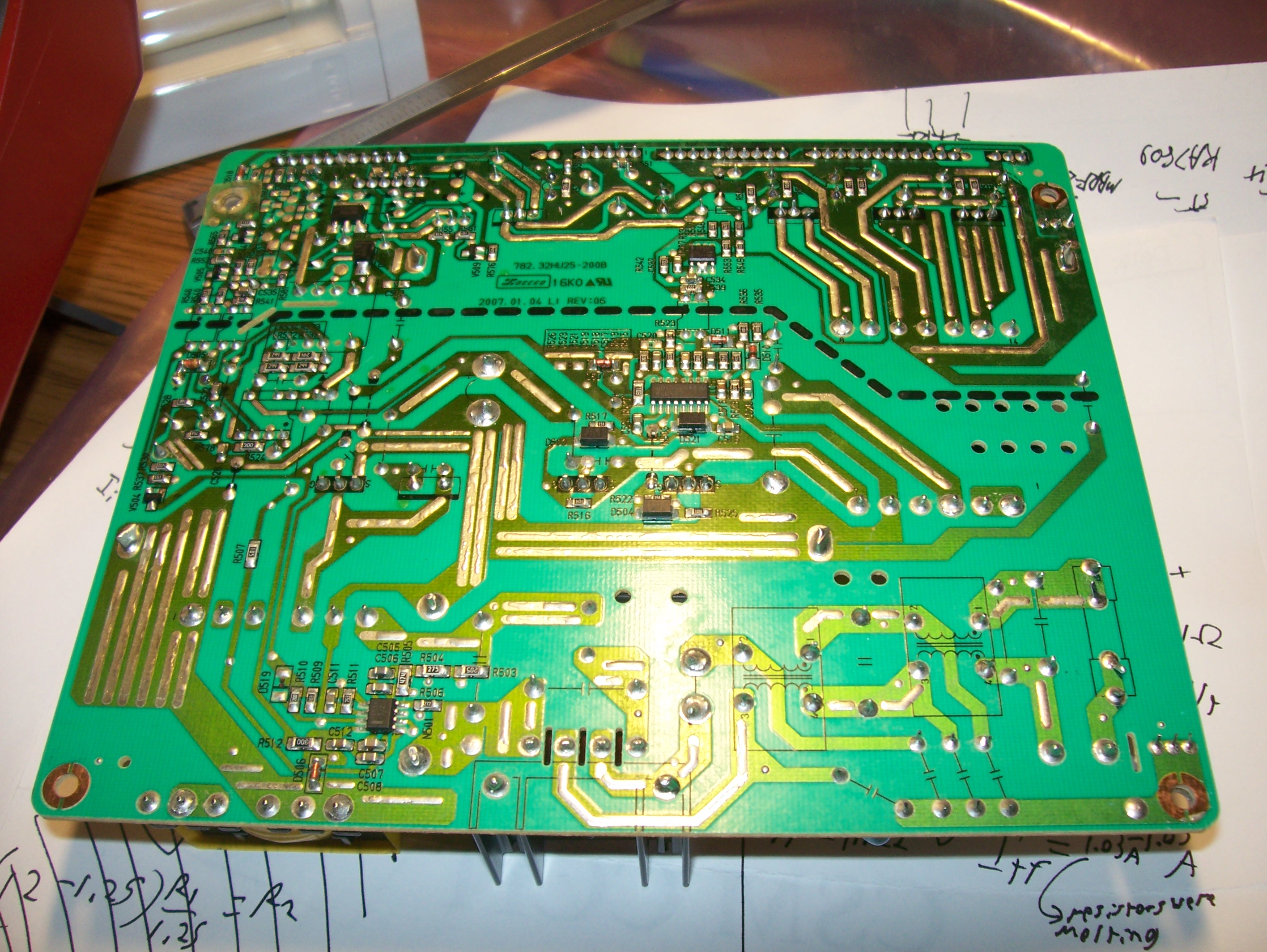

Pictures would help, wouldn't they: (my bad)
Hi again!
Ahh good man, the process of elimination :)
So it looks like that 12V is dodgy, as it worked when you powered it using a seperate 12V supply. I imagine it shut off because of thermal cut-off form your bench power supply - you mentioned current was peaking above what you could read, over an amp, implying the bench supply could only kick out an amp - so perhaps another test using a high current 12V supply. I'm sure its regulation doesn't have to be great, so an ATX PSU from a PC would work, and could supply a fair amount of current on the 12V rails.
I looked at the pics, and altohugh I'm not overly experienced here, but there appears to be tthree switchmode transformers used. That thick dotted black line indicates the seperation between mains/primary side (the dangerous bit) and the low voltage side, as you can see, only two transformers, a couple of optoisolators, and a few caps cross this line. Of the two transformers, the smaller one (left middle of the board) looks like it handles low current, with only one output, the biggest transformer looks like it has 3 or 4 outputs - I am guessing your 12V is on that. The large one at the back left appears to step down mains voltage to a lower voltage, perhaps 60v? which then feeds the two switching supplies, that step this down even further.
Normally, in flyback converters, and forward converters (flyback for<100W, forards are using in ATX supplies for > 100W generally) theres multiple voltage outputs from the transformer. The swithing supply uses just one voltage for regulation, and the others track this (cross regulation). The reaons I brought that up is, for a mlutiple output transformer, if one voltage line sags (say the 12V sags because of too much load), then the other voltages form that transformer will do the same. But seeing as just the 12V line goes here, AND you've tested what its powering to make sure that isn't shorted and drawing excess current, then its most likely the circuitry between the 'big' transformer, and the 12V output.
The above is all guess work because I'm not too well at the moment, and finding it hard to concentrate, so perhaps I'll look into it in more detail later this week (that is, stare at those pics lol)
Good luck, and well done on narrowing it down!
I noticed the SMPS controller chips on that board are SMT. Might be worth googling the part numbers, as often manufacturers use the 'typical application schematic' as a close guide, so whilst component values will be different, it'll give you a good 'typical schematic' of what you're looking at. Heres a goodone I just found:
https://www.electro-tech-online.com/custompdfs/2011/10/NCP1605LCDTVGEVB_MANUALPDF.pdf page: 2
Has two mains inpuit filters, a PFC (power factor correction) circuit - that transformer back left -, and two seperate SMPS's. Just like yours :D
Notice the dual diodes on the outputs of the main SMPS tranformer, theres 12,24 and 30V out on that one, with the 12V out being 3A. Theres just dual diodes,caps, and a filter inductor there. My 'guess' is, if yours is similar to this, then that dual diode has gone, or its output cap has failed so it's voltage sags as it can't keep up.

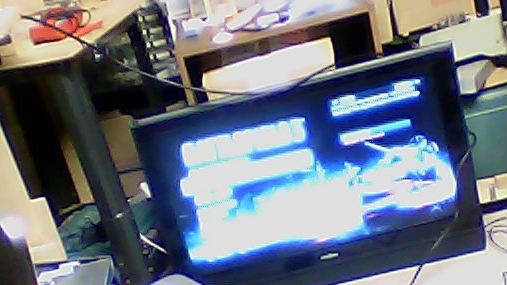

Well, it's been a while, but have I got quite the unbelievable update for you all on this little project!
So. My parts arrived, and I had installed the new caps, schotty diodes, and switching MOSFETS. Now, Unfortunately from here nothing had changed. So, after getting a hold of a serious bench supply and running the same test as I did before, the set did not fire on.
From here I had realized the unrepeatable test I had run about a month ago was unrepeatable for a reason: despite what I had found, the issue never was in the switching power supply, but rather still the logic board. So, as a last ditch effort before spending what would have been a fortune on a new logic board, I thought I'd try something on the last few components on this board I had not tried before.
Following a few guides on re reflowing the main board in a PS3 and a few video cards, I tried the very same thing to the two largest chips on this board using a bit of tin-foil to shield some of the nearby capacitors as best I could and a heat gun. After roughly 5 min of this and letting it cool down, I hooked the board back into the set and it powered on! (who would have thought, a faulty connection with the ball grid array chip)
Of course, being the curious klutz I am, I thought I'd see just how much of a voltage drop there was on the set's 12v supply while it was functioning properly (but forgot my meter was still setup to measure current). Luckily, the 12v line's fuse took care of my fault, and one wire splice later showed that my error didn't damage anything else.

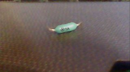

I'll run to the shop tomorrow and replace the blown fuse tomorrow, but any idea of what kind of fuse this may be? (see attached photo) If I can't find something similar, I've got the extra room for a few re-routing wires and a fastblow automotive fuse of the same value (5A).

that's a "resistor fuse", and is as likely to be a slo-blow type as it is a fast-blow type' there should be either a T or an F on the printing somewhere. T means Time delay, F means Fast.... or it's printed on the circuit board near the fuse (if it's a reference designator like F901, ignore that, you're looking for something that says something like T5A or 5F or something like that)
Huh, that's pretty crazy that we don't quite know exactly what causes tin wiskers. Welp, attached is the screen in it's glory, set up on the floor of the shop undergoing testing, the night it was re-assembled with it's replacement fuse.
Since then, this thing has been great! Brought it back to my apartment, and have been searching for a stand for it. Until last evening...
