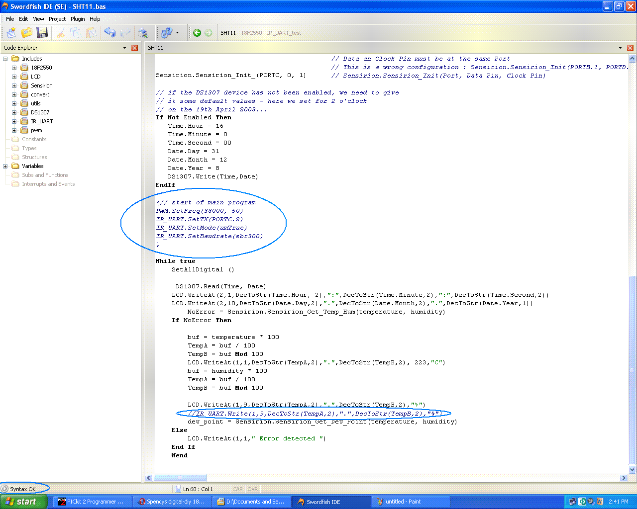

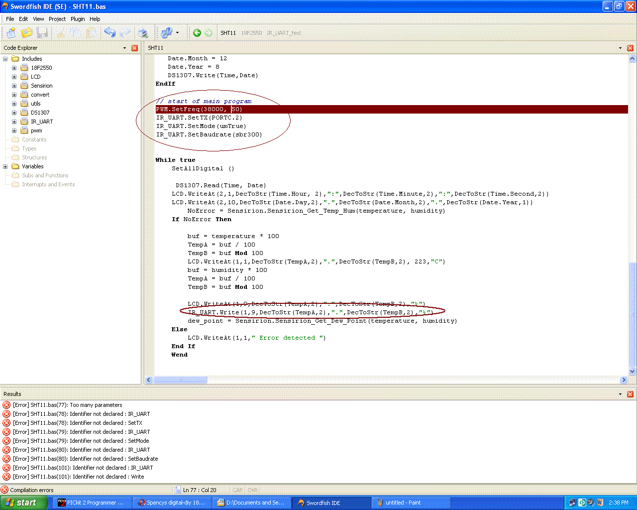

I saw the impressive tutorial in gramo's site.....really great...I can diaplay the SHT11 readings along with time from DS1307 RTC on a 16*2 LCD.....Now wanna transmit it via WUART(i mean wireless UART :) ) through IR waves to another PIC.
see how is it not working. I've included the include files as I've done many times before...when I use the code :
// start of main program
PWM.SetFreq(38000, 50)
IR_UART.SetTX(PORTC.2)
IR_UART.SetMode(umTrue)
IR_UART.SetBaudrate(sbr300)
IR_UART.Write(DecToStr(TempA,2),".",DecToStr(TempB,2),"%")
I get errors.....
without the iR_UART codes....it compiles right..I have tested the program and appeared to work fine

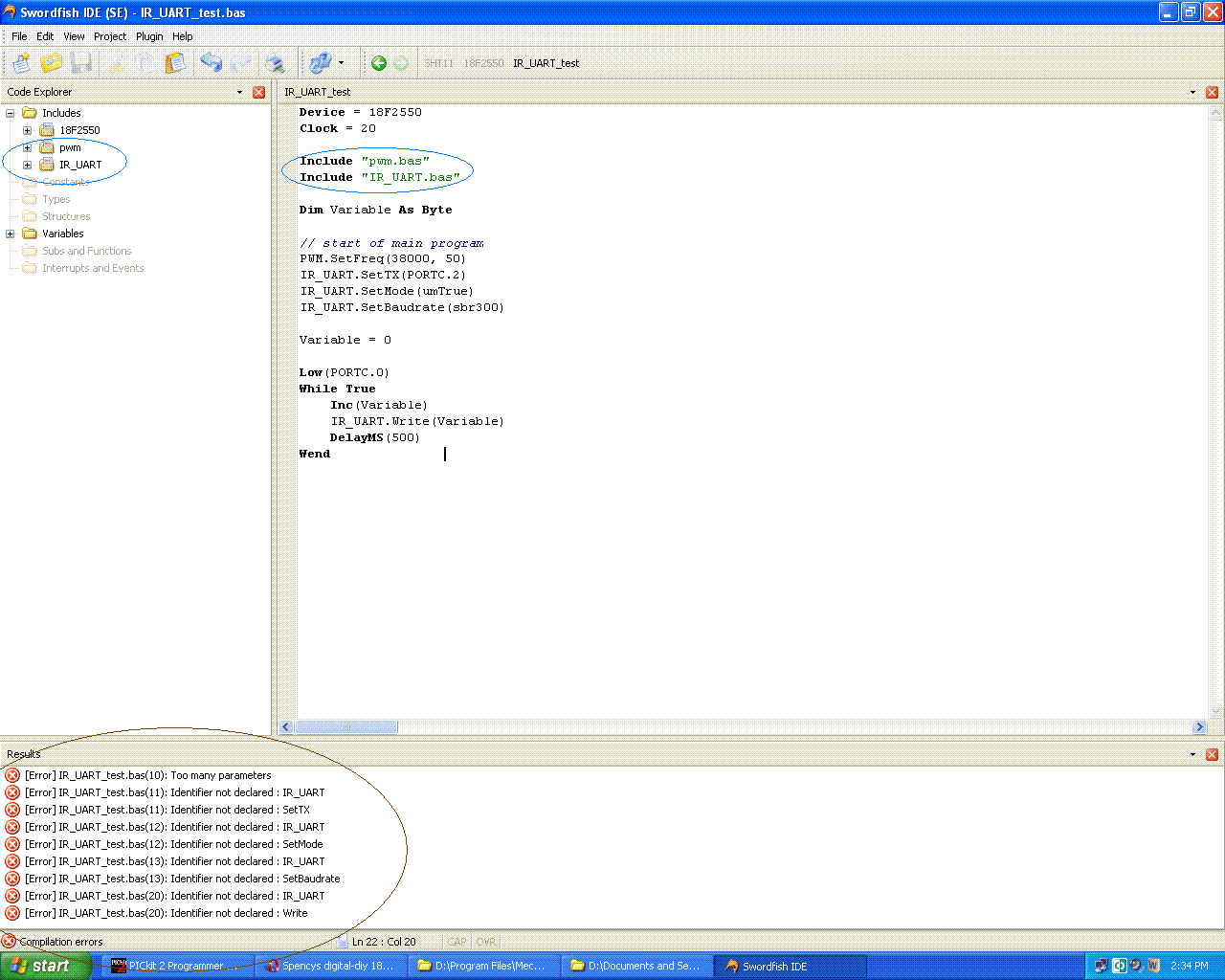

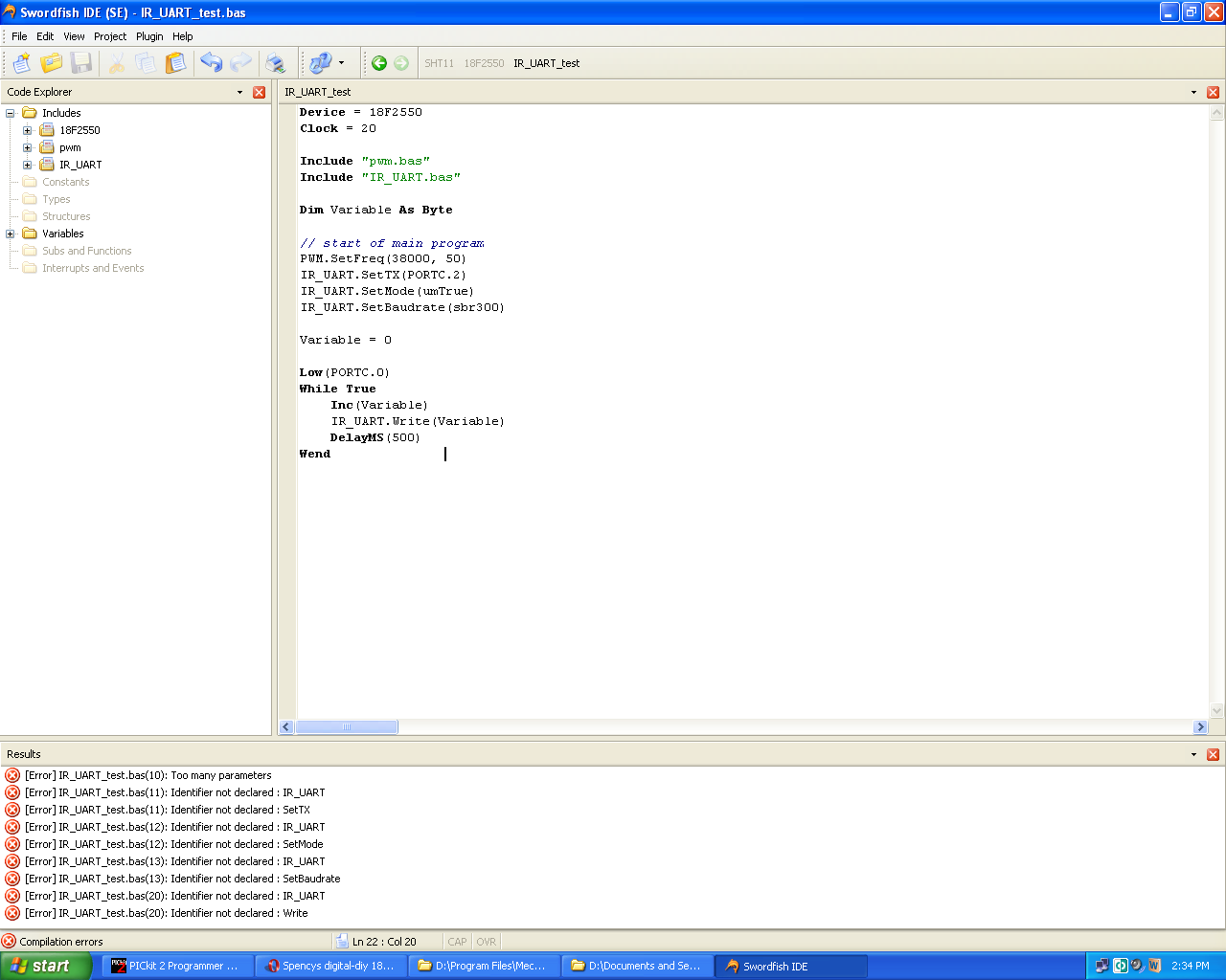

even this sample program wont work....
Device = 18F2550
Clock = 20
Include "pwm.bas"
Include "IR_UART.bas"
Dim Variable As Byte
Variable = 0
Low(PORTC.0)
While True
    Inc(Variable)
    IR_UART.Write(Variable)
    DelayMS(500)
Wend

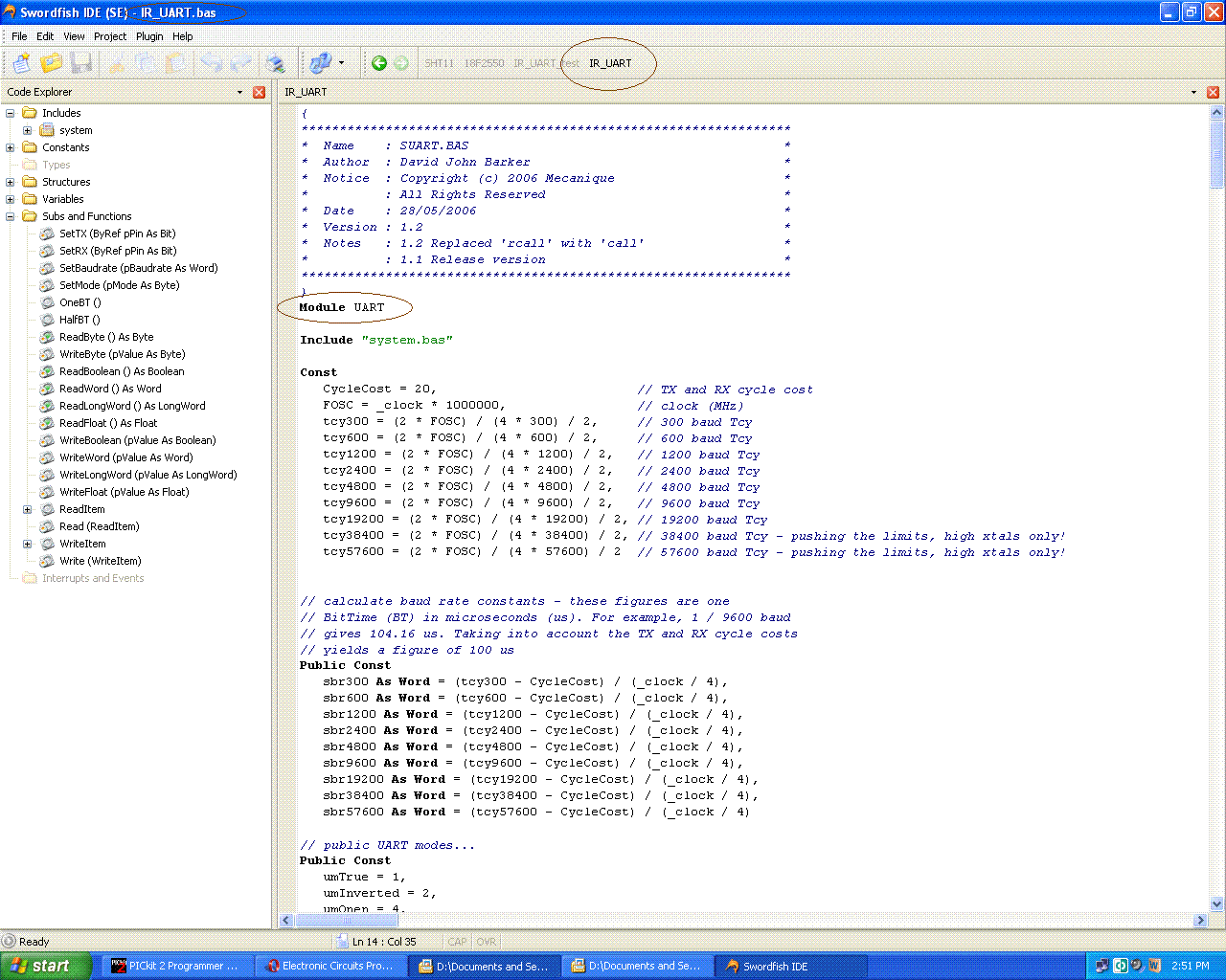

Another thing to doubt most when I open the IR_UART.bas include file I see this code: which I think is a code of swordfishe's UART module..and NOT a IR_UART....I downloaded the IR_UART.bas file from **broken link removed** aka gramo's PIC....anything wrong? the IR_UART.bas file shows :
*  Name    : SUART.BAS                                         *
*  Author  : David John Barker                                 *
*  Notice  : Copyright (c) 2006 Mecanique                      *
*          : All Rights Reserved                               *
*  Date    : 28/05/2006                                        *
*  Version : 1.2                                               *
*  Notes   : 1.2 Replaced 'rcall' with 'call'                  *
*          : 1.1 Release version                               *
Module UART
Include "system.bas"
Const
   CycleCost = 20,                          // TX and RX cycle cost
   FOSC = _clock * 1000000,                 // clock (MHz)
   tcy300 = (2 * FOSC) / (4 * 300) / 2,     // 300 baud Tcy
   tcy600 = (2 * FOSC) / (4 * 600) / 2,     // 600 baud Tcy
   tcy1200 = (2 * FOSC) / (4 * 1200) / 2,   // 1200 baud Tcy
   tcy2400 = (2 * FOSC) / (4 * 2400) / 2,   // 2400 baud Tcy
   tcy4800 = (2 * FOSC) / (4 * 4800) / 2,   // 4800 baud Tcy
   tcy9600 = (2 * FOSC) / (4 * 9600) / 2,   // 9600 baud Tcy
   tcy19200 = (2 * FOSC) / (4 * 19200) / 2, // 19200 baud Tcy
   tcy38400 = (2 * FOSC) / (4 * 38400) / 2, // 38400 baud Tcy - pushing the limits, high xtals only!
   tcy57600 = (2 * FOSC) / (4 * 57600) / 2  // 57600 baud Tcy - pushing the limits, high xtals only!
// calculate baud rate constants - these figures are one
// BitTime (BT) in microseconds (us). For example, 1 / 9600 baud
// gives 104.16 us. Taking into account the TX and RX cycle costs
// yields a figure of 100 us
Public Const
   sbr300 As Word = (tcy300 - CycleCost) / (_clock / 4),
   sbr600 As Word = (tcy600 - CycleCost) / (_clock / 4),
   sbr1200 As Word = (tcy1200 - CycleCost) / (_clock / 4),
   sbr2400 As Word = (tcy2400 - CycleCost) / (_clock / 4),
   sbr4800 As Word = (tcy4800 - CycleCost) / (_clock / 4),
   sbr9600 As Word = (tcy9600 - CycleCost) / (_clock / 4),
   sbr19200 As Word = (tcy19200 - CycleCost) / (_clock / 4),
   sbr38400 As Word = (tcy38400 - CycleCost) / (_clock / 4),
   sbr57600 As Word = (tcy57600 - CycleCost) / (_clock / 4)
// public UART modes...
Public Const
   umTrue = 1,
   umInverted = 2,
   umOpen = 4,
   umOpenTrue = umOpen Or umTrue,
   umOpenInverted = umOpen Or umInverted
// a pin structure...
Structure TPin
   AddrPort As Word
   Pin, PinMask As Byte
End Structure
// private variables and aliases...
Dim
   FTX As TPin,                       // TX pin
   FRX As TPin,                       // RX pin
   FBaudrate As Word,                 // Baudrate (1 BT)
   FHalfBaudrate As Word,             // Half Baudrate (1/2 BT)
   FMode As Byte,                     // Mode (true, inverted)
   FPacing As Word,                   // write byte pacing (us)
   FTerminator As Char,               // read string terminator character
   FIsInverted As FMode.Booleans(1)   // inverted mode flag
// public variables...
Public Dim
   ReadTerminator As FTerminator,     // read string terminator
   Pacing As FPacing                  // write pacing (us)
........ETC

I'm 100% sure that it's not the correct library file "IR_UART.zip>>>IR_UART.bas"...isnt the library that either gramo told or i want...

The IR library was not the correct one, its since been fixed and can be downloaded from the **broken link removed** or **broken link removed**
The reason why I use the libraries is to allow a very simplistic approach toward programming. It also allows standard integration for selecting the appropriate defines such as UART baud/mode as you would with the original Swordfish library. For example;
