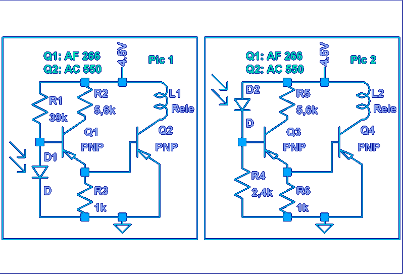

How cod you mistaken an IR reciver(3 pins) whith an foto transistor(2 pins).
An photo diode shod work instaed of an photo transistor.
Here insted of an photo transistor an photo diode is used
On pic1 the rele coil stops geting power in the dark.On pic2 i its the poposite
Wait a minute...Ops :oops: The ground shod me 4.5 V and the 4,5 V the ground :oops:
