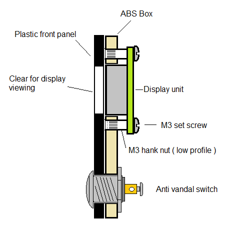

Here is how I mount my 16x2 Fordata LCD..
Plastic ABS box....
Bottom cut out to suit the display part....
4 holes drilled to 4.5mm in line with the 4 mounting holes....
3mm hank nut pushed into the back of the box through the 4.5mm hole...
The display sits flush to the rear of the box..
Printed panel sits on the rear of the box held down by 4 anti vandal buttons...

Do you have any pictures? :D
I was going to post them, But as I have just found out my web site is down... I have BT on the case but it'll be Tuesday before we're back up and running...
However I have pictures on my work computer... The nuts are actually called Clinch nuts
https://www.ebay.co.uk/itm/Grooved-...f2863&pid=100204&rk=20&rkt=29&sd=361205074936
Works quite well and I mount it all on a stainless steel bracket that I have made. ( the steel is sandwiched between the ABS box and the Front panel.
I use Sikaflex to stop water ingress....
Yes, I know of them, but never had any (or even physically seen one) - I became aware of them as they were listed in the leaflet with my pop-riveter, and I always thought they looked useful (RS Components sell them).
I was thinking of something similar, but using countersunk 3mm screws from the front, and nuts on the back so you can adjust the mounting depth as you want. Do the clinch nuts happily give you the right depth?.
Yes.. Spot on... They allow me to tighten the screws down hard without deforming the PCB... The clearance to the steel bracket is gnat's hairs....... The perspex front is "Reversed" printed so it doesn't get scratched, and they can polarize it so its sun readable..
The LCD's without the backlight sit miles away so they look awful so I don't use them...
