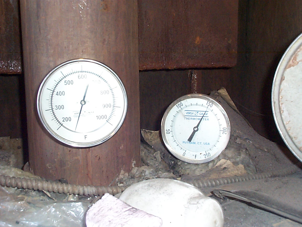

what is the avg temperature of your exhaust?
At idle around 250 - 300 F according to my stack temp gauge. At full burn around 500 - 800 F depending on whats burning.

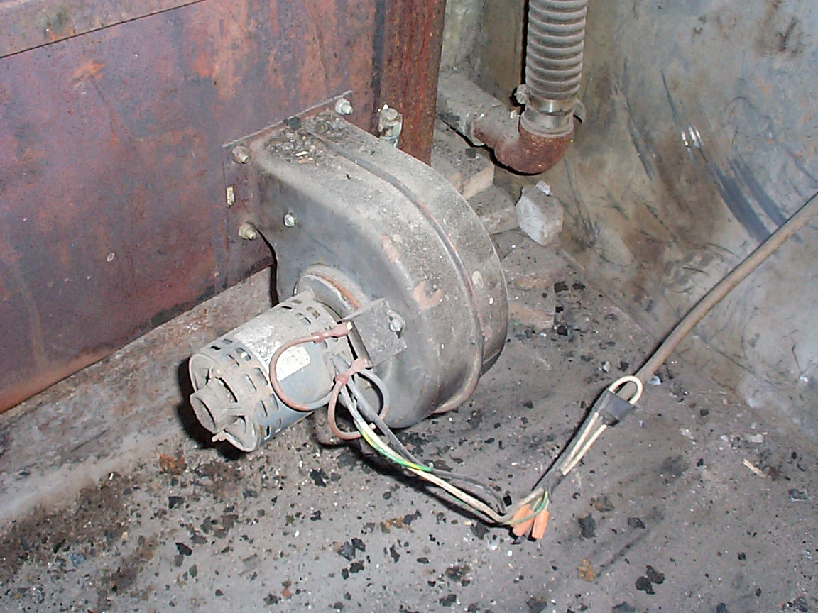

For air I use two squirrel cage blowers. One blows air in from under the fire at about 100 CFM and the other blows air over the fire from the front door at around 250 CFM if I am remembering there specs number right. The dual draft system gives it a good clean burn that way plus solved a lot of flame control and burning efficiency problems that the old design had with a single bottom draft and power stack draft system.

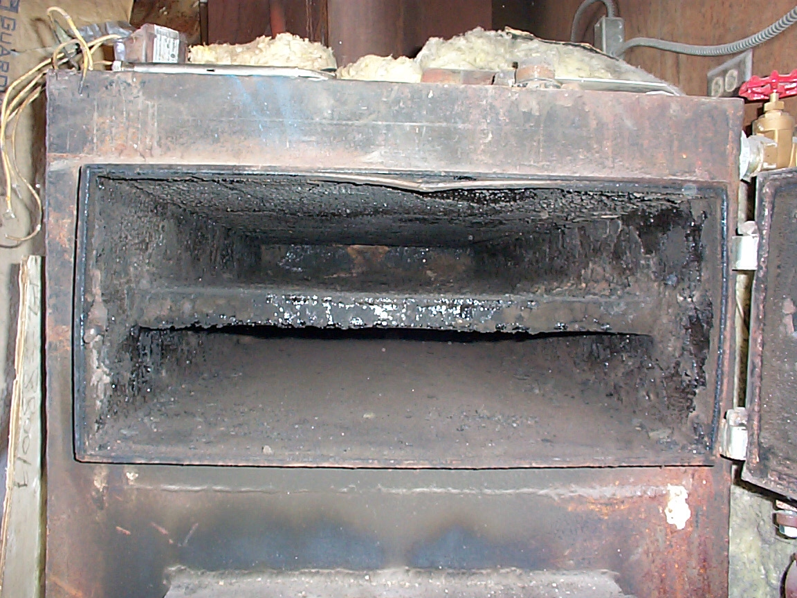

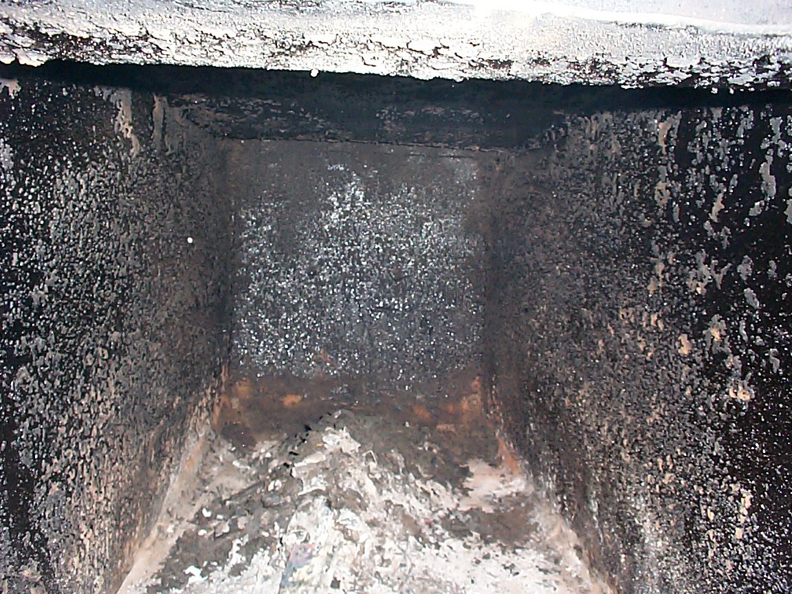

Here are the pictures.
The first one is the flues looking at them from the front through the clean out door. The combustion gases come up in the back of the lower one travel to the front do a 180 degree turn and go to the back of the top one and up the stack.
This is the fire box. It is 24 inch's square by 54 inches long.

This is the door draft blower that blows the draft air in over the front and top of the fire.
These are the pallets startling to burn and on the right side you can see some of the holes that the door draft air blows out of. They go all the way around the outer part of the inside of the door.
These is the two mechanical gages that read the stack temp and water jacket temp.

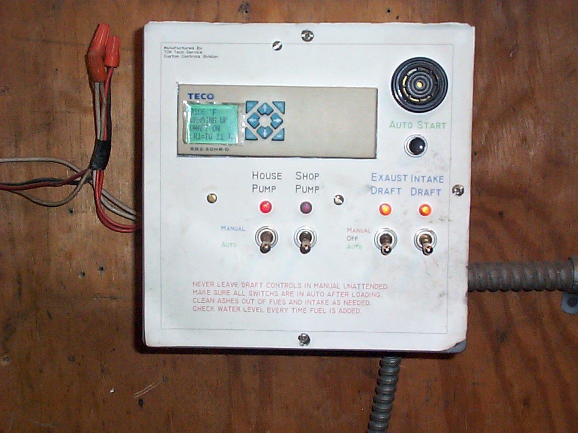

This is the digital controller I designed for it.
Although the design itself does not look all that complex the overall work behind it took a good deal of research and trial and error testing to develop. Its a square body design with an open system so that it can not build up pressure. My insurance company classifies that as a open hot water heater not a boiler so I don't pay any additional insurance fees for having it.
