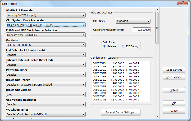

Now, I understand that you have to set the speed from the configuration settings. Here's mine:
However, the blinking period doesn't match the computer clock (I watch the sync between the clock ticking and the LED blink) which I'm using as a reference. It seems the PIC is going a tad bit faster but definitely noticeable. This has made my subsequent programming (which involves UART and other comm protocols) a problem.
I've tried some combinations like changing the Prescaler, CPU postscaler, and whatnot but this hasn't helped. I've definitely understood this whole clocking part poorly.
Anybody can point me in the right direction?
Thanks.
Vizier87
EDIT: I've set the oscillator as 19 MHz as part of my attempts to see if this makes it more accurate. It seems to have changed but still a very messy thing to do. Hasn't worked also though.

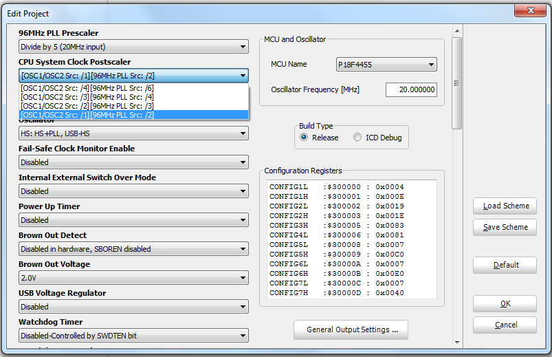

Hi Ian, here are the options:
The highlighted one gives a much faster output and the top one gives a slower blinking rate.. I'd say by 1.5 times.

RightyO!!
Quick understanding of said datasheet and we're off!!
20Meg crystal.....96Mhz PLL src: /1 = Micro = 20Mhz
96Mhz PLL src: /2 = Micro = 10Mhz
96Mhz PLL src: /3 = Micro = 6.6Mhz
96Mhz PLL src: /4 = Micro = 5Mhz​
With HSPLL.........96Mhz PLL src: /2 = Micro = 48Mhz
96Mhz PLL src: /3 = Micro = 32Mhz
96Mhz PLL src: /4 = Micro = 24Mhz <- your Osc speed!!
96Mhz PLL src: /6 = Micro = 16Mhz​
So even though you have a 20Meg crystal your OSC block is running at 24Mhz...
The system crystal / 5 gives a 4Mhz starting block... This is jumped up to 96Mhz... then the cpu OSC is divided down
so OSC1/OSC2 src: /3 [96Mhz / 4] = 24Mhz is the correct setting...
You need.. CPU System Clock Prescaler needs to be /4, and the OSC Frequency needs to be 24Mhz.

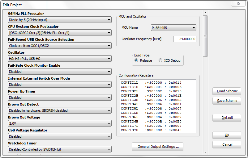

I followed your instructions:
The whole thing is a poor man's work. Just trying to earn something from here if what follows would work. No wonder my previous transmission with an Xbee was totally in disarray!
Thanks a million, Ian. I'm gonna put your name in my code.
