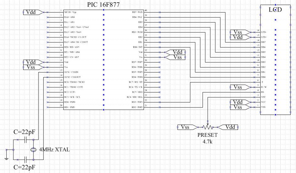

Actually I'm wondering why my program cannot apply to the LCD, while it is correct. The connection pins also connect to proper way. Is that my program doesn't suit to the circuit?
The LCD schematic diagram is attached:

I will rewire my test board to suit your PIC pinouts to the LCD, then load your program into a 16F877 and give it a run.
Do you have a datasheet for the LCD module, just in case there are any differences between the Hitachi and your LCD controller.?
To be sure your PIC setup is OK, write a simple LED ON/OFF program, this will check that your PIC16F877 is actually working.:rolleyes:
Downloaded the datasheet, they are the same.
Modified my project board to suit your wiring.
Programmed a PIC 16F877 with your program.
The Delays are too short, as you are not testing Dbit7 for BUSY, the LCD controller is not initialising correctly.
As a quick check increased your program delays by a factor of 3 [ called the delays 3 times each].
The LCD works OK.
Displays my test data:
Yes
Hello
With no problems.:)
Did you manage to see any pixel blocks while adjusting the contrast pot, its MOST important that the blocks can be made visible!!

Hi, sorry for late reply.
what do you mean by Dbit7 for busy?
I was using 4.7kohm variable resister to adjust the contrast pot. when I was adjusting, there is nothing come out from LCD. The LCD only on the light.
Today, I tested the LCD hardware with your edidted program. But failed. At first, some pixel blocks came out, but gone after few minutes, LCD light still on....Is that my LCD or connection problem?I was connect the Vee to ground, could I connect by this way? Is it correct?
I'll attach the LCD datasheet that I'm using, and could you explain why my delay time and initialising of LCD is not correct since I follow the datasheet. I'm sorry, my knowledge about PIC microcontroller is limited. Hopefully I can gain some knowledge from you. Thanks!

You don't need the PIC to test if your LCD module is ok.
After removing the PIC from its socket and giving power to the LCD, you should see a row of black rectangular boxes, as already pointed out. If the LCD passes this test, you can use it in your circuit and write the firmware.
Perhaps the backlight is causing troubles? In the schematic you posted I don't see a current limiting resistor between pin 15 and Vdd of the LCD module and it might be drawing too much current and behaving unpredictably? Just an idea though... since you say that you've double-checked the wiring and I trust Eric as far as the program is concernerd :)

erm.... What do you mean by the backlight is causing troubles?
So, I've to connect a resister between pin 15? What about the value of resister? Is between 1kohm to 10kohm?
Thanks for your suggestion!
The value depends on the LEDs' current, that is usually specified in the datasheet of the LCD module. If you're assembling this circuit on a breadboard, just leave pins 15 and 16 of the LCD floating (no backlight) and see what happens.

eng1 and I, consider the possibilty that without the backlight LED current limiting resistor, the +5V supply line could be getting pulled down, if held down long enough the +5V regulator could be going into thermal shutdown.
You said that you had the pixel blocks for a while then they faded away, this again suggests a possible power supply problem.
Do as eng1 suggests, disconnect the LCD backlight..:)

We are trying to debug his project, the problem is that we are not sure if the LCD is faulty, the wiring wrong or the power supply/backlight is at fault.
The programs have been run OK in PIC's on my system OK.
We are suggesting removing the backlight as a possible cause of his problem, its not needed at this stage.
When the LCD works then he can put the backlight on...:)
