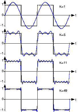

You should know this from Fourier analysis. What are the Fourier coefficients for a square wave? Don't they extend up to an infinite number of harmonics of the fundamental frequency?
Another related detail, which is quite mystery to me, is that an impulse contains all the possible frequencies with the same amplitude (misterT also mentioned it twice in this thread). Now, an impulse is nothing more than a vertical straight line and I can't see any cycles there! If I have a graph of sine or cosine wave I can clearly see the cycles and hence frequency. This proves I can trust my eyesight but not my mind!
You can't see the cycles because when you add up an infinite number of sine waves with all frequencies, you get a narrow pulse. It's just a result of the math. If you want to see the cycles, write a computer program to try and do the addition of the sine waves for both a square wave and a Dirac impulse function. Since you can't really add up an infinite number of things with a computer program, you will see functions that only approximate these functions, and you will see ripples with higher frequencies. (EDIT: I found a picture with the square wave and attached it)

I couldn't find any diagram which shows that as you add up more and more number of sine waves with increasing frequencies, the result gets closer to an ideal impulse. Could you please help? I have also searched for an applet of fourier transform but couldn't find it.
This PDF shows fourier series approximation of a square wave.

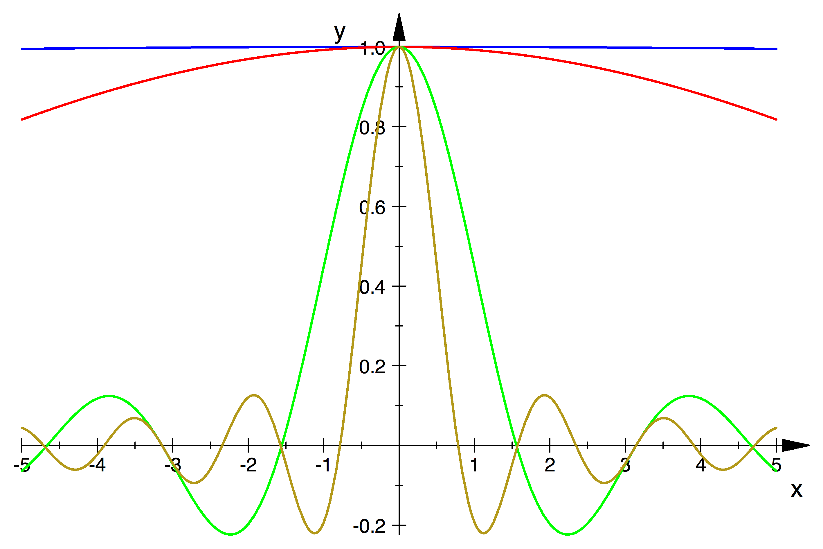

What you can try is to write a computer program that adds up lots and lots of sine waves over a wide band with very narrow spacing between the frequencies. You won't be able to make an impulse, but you should be able to at least make a narrow pulse. This won't be a square pulse, but remember that an impulse does not really have a shape to it, so what you are looking for is a function that gets narrower and narrower as you add up more and more frequencies.
Here I can give an example. Let's try summing up first 1 cosine wave, then 10, then 100 and then 200. I've attached the plot. Notice how a narrow pulse is formed and you can still see the ripples at high frequency. If the summation is extended up to infinity and if the frequency spacing is decreased to zero, you will get a prefect impulse function.
[latex] \cos(0.02\;t)[/latex] blue
[latex] \frac{\sum_1^{10}\cos(0.02\;n\;t)}{10}[/latex] red
[latex] \frac{\sum_1^{100}\cos(0.02\;n\;t)}{100}[/latex] green
[latex] \frac{\sum_1^{200}\cos(0.02\;n\;t)}{200}[/latex] amber
Note that i normalized the functions so that they have a peak at value of 1 at t=0, but the real function get larger and larger at t=0.

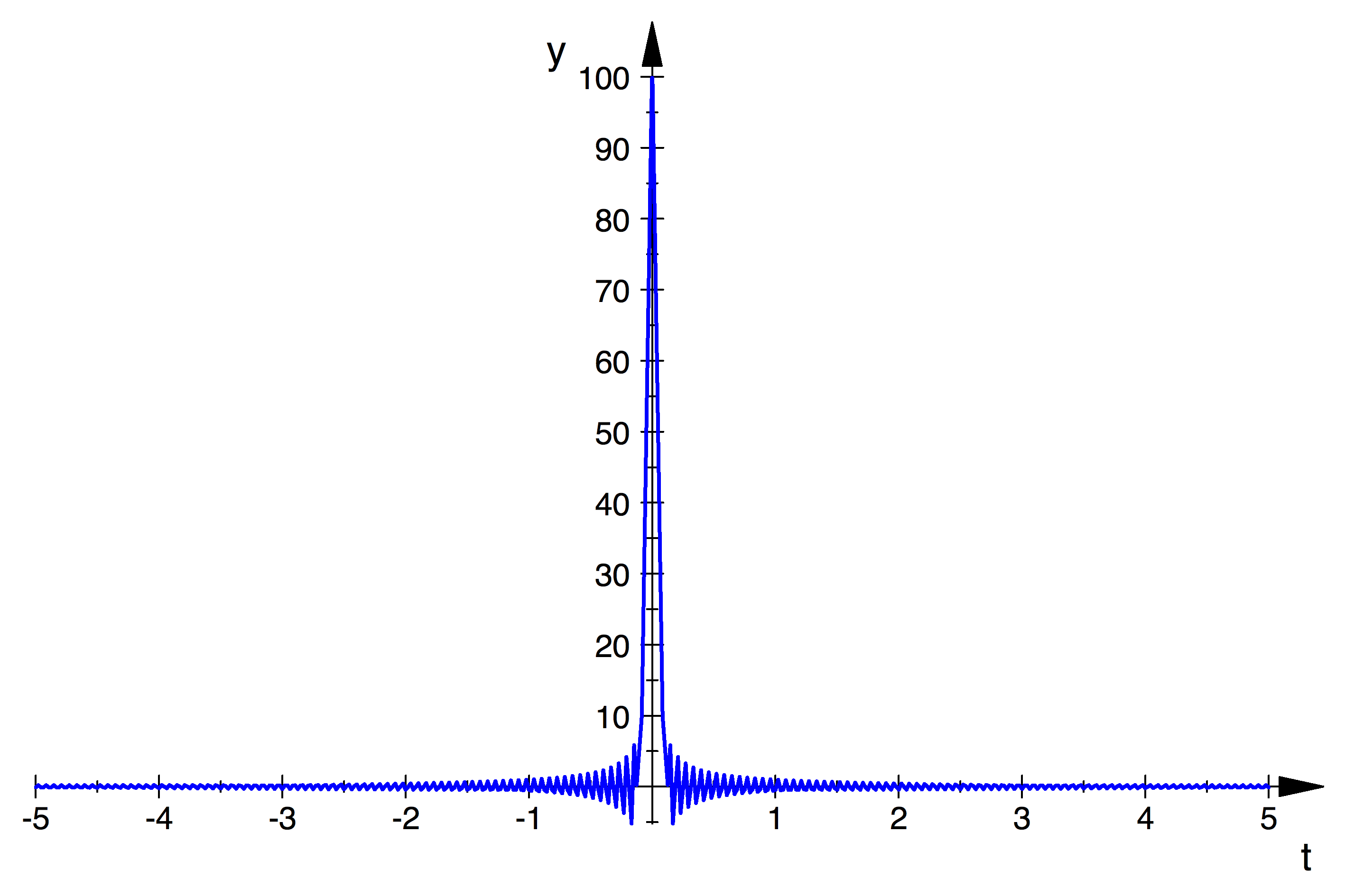

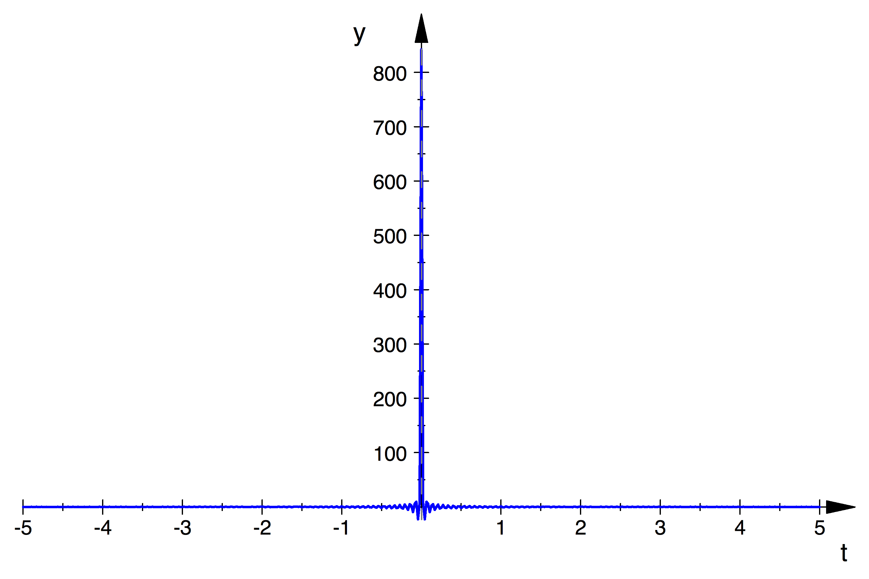

There is another way to calculate it too, using integrals instead of summations. Here is a plots of the following integrals.
[latex]\int_0^{100} \cos{(wt)}\;dw[/latex]
[latex]\int_0^{1000} \cos{(wt)}\;dw[/latex]
By letting the upper limit in the integration go to infinity, you get the impulse funciton.

The thing that is special about square and triangle functions is that they are periodic functions that have discontinuities in the function and the derivative, respectively. (edit: i removed incorrect sentence here) I think we can extend this notion and say that the harmonics will usually not extend to infinity if the function and all derivatives of any order (i.e. first, second, third derivative ... etc.) are continuous. Also, the harmonics usually must extend to infinity when you have kinks in the function or any derivatives. I'm tempted to remove the work "usually" but that would require a lot of thinking to make sure there are no special cases/exceptions, since we know that most rules have exceptions.
Basically a finite frequency sine wave can't make a kink because it does not contain any kinks itself. However, a sine wave with infinite frequency (combined with an infinite sum) has the ability to change infinitely fast (in a crude sense, -please mathematicians don't throw a spear at me). Although, this is not in any way a formal proof, hopefully you can get a feel for it by thinking in these terms.
