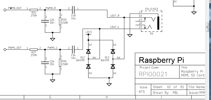

The raspberry pi generates its audio using PWM and passing the signal through a passive Bandpass filter:
I am trying to create an audio player (for indoor use) by passing the audio signal into and amplifier and into a pair of small (1.25" -> 2") 4Ohm speakers.
I am currently playing around with the PAM8406 amplifier and it delivers a decent audio.
My question is, on a budget of a few dollars ( like < $5), is there any additional "filter" circuitry I can add to the pi output and any better general purpose ampifier IC that can be recommended to improve the clarity and maximize sound generated.
Currently with the PAM8406 turned up to full there is a noticeable ssssshhhhh sound with and without audio playing.

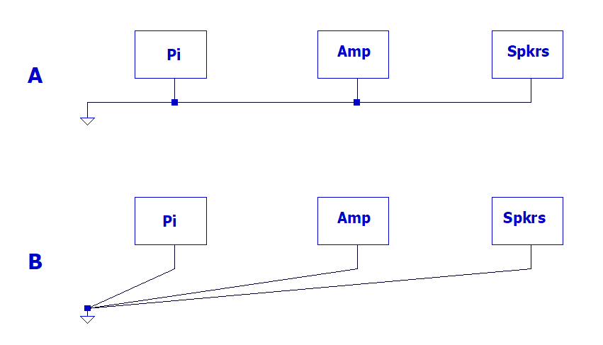

From your description, the noise may be due to currents in the ground rail and nothing to do with the PWM.
Your RC filter corner is ≈50kHz which is higher than you need..
You might try reducing that to ≈20kHz by increasing the capacitors to 82nF and see if that makes a difference.
Shhhh is high audio frequencies. If you use a filter to cut that sound then music and speech will have no high audio frequencies and will sound like an AM radio or an old telephone.

On your point of ground rail currents, is there a way to reduce/isolate this?
Yes. In the pic below, 'A' shows a shared ground rail layout where Pi current causes voltage drop on the ground rail, which will affect the amp. 'B' shows a star ground layout, where Pi current won't affect the amp.
