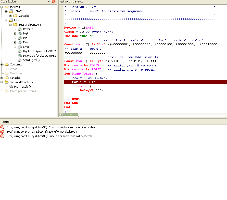

implermenting a CONST array
MrDEB
trying to figure out how to implement a CONST array as shown here.
Keep getting as syntax error.
Can't be all that hard but trying to find an example of an easy method?
Trying to control a 5x7 LED matrix and using a const arry looks like the easiest way as I need to use the same basic patterns over and over.
Then need to have the LEDs to LOOK like they are staying on (POV)
Device = 18f452

Are you going to give us a clue where the error is? My guess would be the comment splitting the line,
Const colm(7) As Word =(%00000001, %00000010, %00000100, %00001000, %00010000,
// colm 2 colm 1
%00100000, %01000000 )
using swordfish compiler
sorry I didn't mention
I tried changing a few things around but still no avail. Using examples I found here and there but ?
using other codes as example
I got this code so I have no syntax errors but do I still need to put SetAllDigital in and did I set up portA and D correctly?
been just tinkering with code trying to understand what I have and did??
maybe not correct way but any suggestions on what I did or have wrong?
