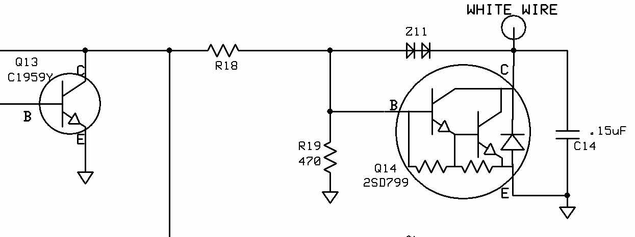

I'm currently completing my first reverse engineering - on a Suzuki GS450's igniter (CDI or powerpak).
1982 model so that you may have an idea about electronics era.
I figured out most but I'm having doubts about two diodes in series placed across a Darlington **broken link removed** (sub 2sd1409a) from its base to collector.
Emitter is grounded as with all switches (transistors) on this board (other than 1 jfet).
In addition to this duet-series-diode, the collector (driving/interrupting the ignition coil) has a 0.15uF on it to ground.
I read somewhere that these diodes connected in series would give 2(0.7V)=1.4V drop - acting as a voltage regulator (which makes sense since automotive applications have a varying 12V supply).
If it's a general diode, I assume that this configuration would regulate the base to a voltage ALWAYS 1.4V less than the collector, is nonsense as the diode is pointed towards the collector???
Silkscreen suggests that it's a Zener which I'm a bit reluctant to check as I have done only up to 12V with no indication...
The markings on the "2-pac zener" diode are (each diode): T 1Z 175 1.l
Yes, that is a 1.l and NOT 1.1:confused:
I searched for a 1W 175V zener (1z175) but it seems extremely rare if in existence.
Is this really a 175V zener diode or a general series-doubled-diode?
If these are really Zeners, will this give protection, value, regulation, reference or what?

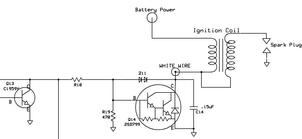

Note that this drives the primary winding on the ignition coil which gets a constant 12V supply from battery.
It operates similarly to the points in the older stuff (sparks when points open).
Here's the schema:

It seems like an odd place to put it, but it could be a MOV.
Can you post a picture of the actual part?
To me it looks like a fast recovery diode.

Also, remember that the white wire "W" goes to the ignition coil (primary winding) which is fed battery power 12DCV-14DCV on the other end of this primary winding.
The secondary winding goes to spark gap (spark plug) which is grounded through the cylinder head (engine).
The primary winding is series connected to the secondary winding.
This is where the "W" or white wire is tapped in.
I assume this diode set is to protect the Darlington (Using a transistor as a switch).
"Protection diode
If the load is a motor, relay or solenoid (or any other device with a coil) a diode must be connected across the load to protect the transistor from the brief high voltage produced when the load is switched off."

Yes, it looks like the 2 zeners are designed to turn on the 2SD799 when the voltage across it rises to apx 350V, thus clamping the maximum voltage across the transistor. The transistor has a max CE voltage rating of 400V.
Modern Ignition IGBT's have this zener built in, its part of what makes them robust for ignition coil switching.

You can always use more than 2 Zeners to get the total breakdown Volts.
75V zeners should be readily available.
About the 50 Volt protection=Exactly 100% correct!
