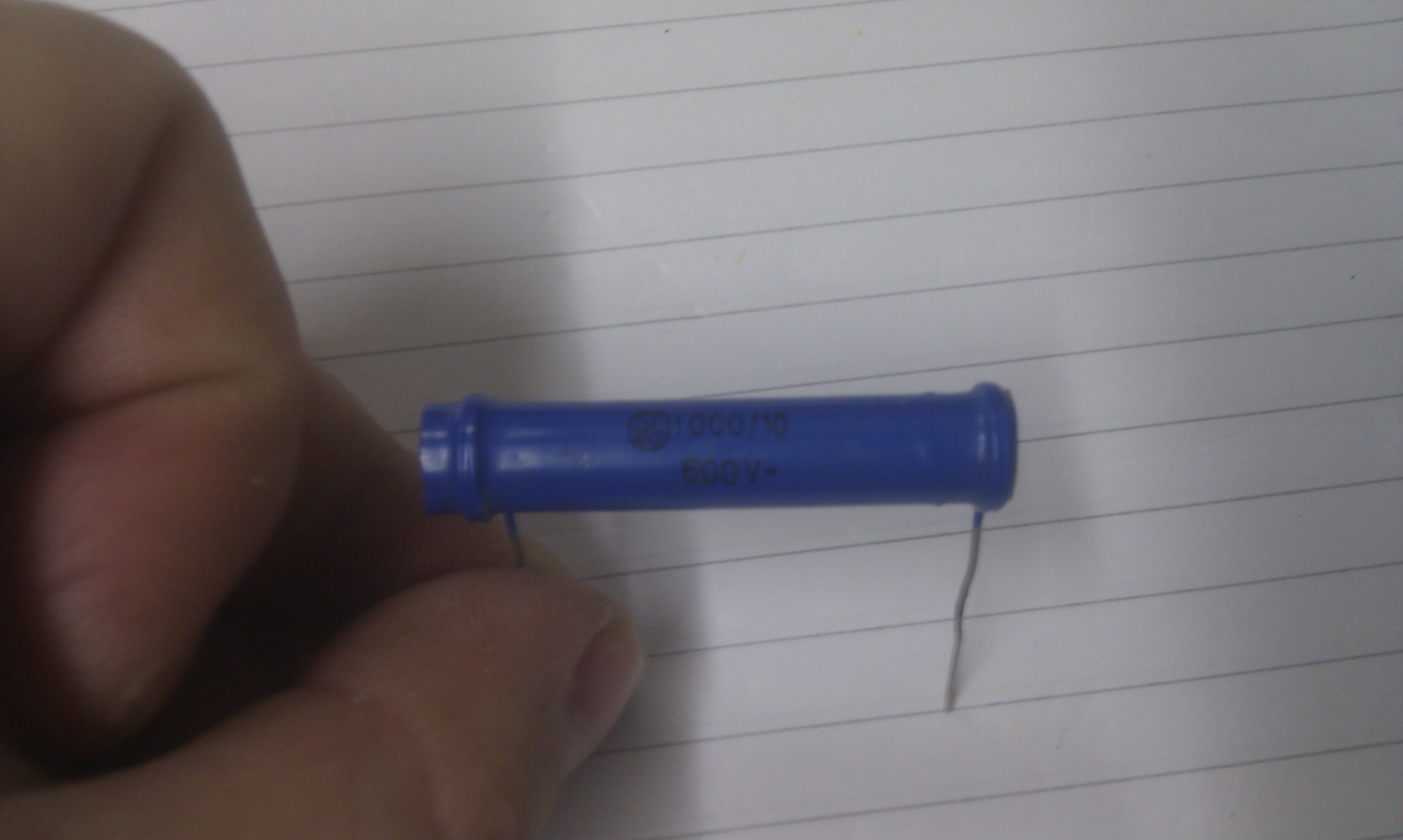

Identify resistor looking component?
I found a drawer of these components at work during a clear out, but cannot identify what it is. It has off the scale resistance (open circuit), doesn't have any capacitance. My colleagues can't figure out what it is either.
Does anyone know what this could be?
Thanks,
Jules.

1000pF +/-10% tolerance 500v capacitor.
