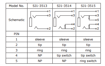

I asked the seller about this 4-pin 3.5mm stereo jack. A 3-pin stereo jack would be
normally open (NO) or normally closed (NC). As you can see, this jack has 4-pins.
The extra pin probably means you have the option of connecting this jack both ways,
depending on which configuration you need.
The seller didn't know. The answer seems obvious to me, but I've purchased components
through eBay that were not what they appeared to be. If you're 100% certain, please
let me know.
Thanks guys.
This is probably pretty close: **broken link removed**
Note: Your device has 5 pins in the eBay illustration.

I really want several open frame (NC) jacks like the attached image. eBay has
a lot of these jacks from China, but they all appear to be normally open.3.5mm NC Stereo Jack.jpg
A 3-pin stereo jack isn't normally open nor normally closed. A 3-pin stereo jack has three direct connections (tip, ring, and sleeve) and no switching functions.
The jack in your link is the same as the right-most schematic, SJ1-3515. This has a switched tip contact and a switched ring contact. You can ignore the switch pins (4 and 5) and use it as a normal stereo jack.
