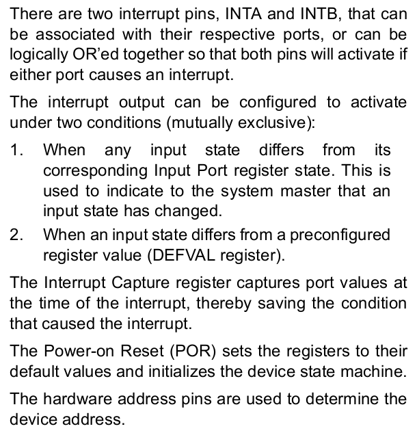

well, the I2C port extender is not that good for sensors as you cannot control it that fast, but you can move all relay's to I2C port extender. That is 3 ports on the PIC free immediately :) (you already have i2c bus so port extender chip is not taking any)
I'm not sure what 7555 is? some "advanced" 555? if yes, then I assume you want to "start/stop" it using RC0/RC1 ... this can also go to port extender ...
so .. 4 pins freed, you can free the fifth also if you move the button to the port extender but then you either need to pull data often or you need to connect INT pin from port extender to uC (so then that fifth ping is occupied again, but port expander becomes more usable :D and you can use it for other purposes)
btw, as you do not need 3mhz clock on the i2c you can use cheaper pcf8575 port extender.

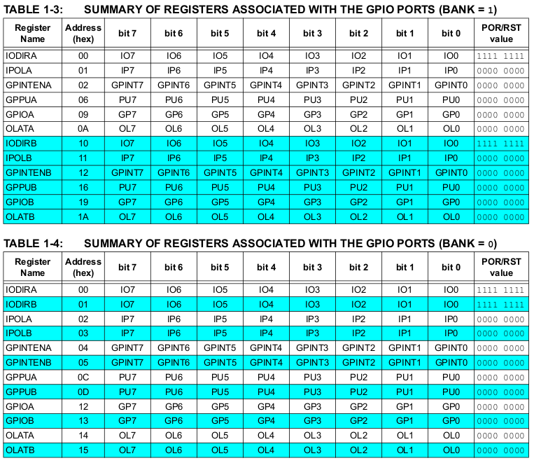

The port extender (expander) is pretty nifty thingy that many hobbyists ignore. They also have interrupt pin to "notify" the master about the "change" .. MCP23017 have 2 interrupt pin's for example that can be configured to trigger interrupt on different events...
check: https://www.electro-tech-online.com/custompdfs/2009/02/21952b.pdf
