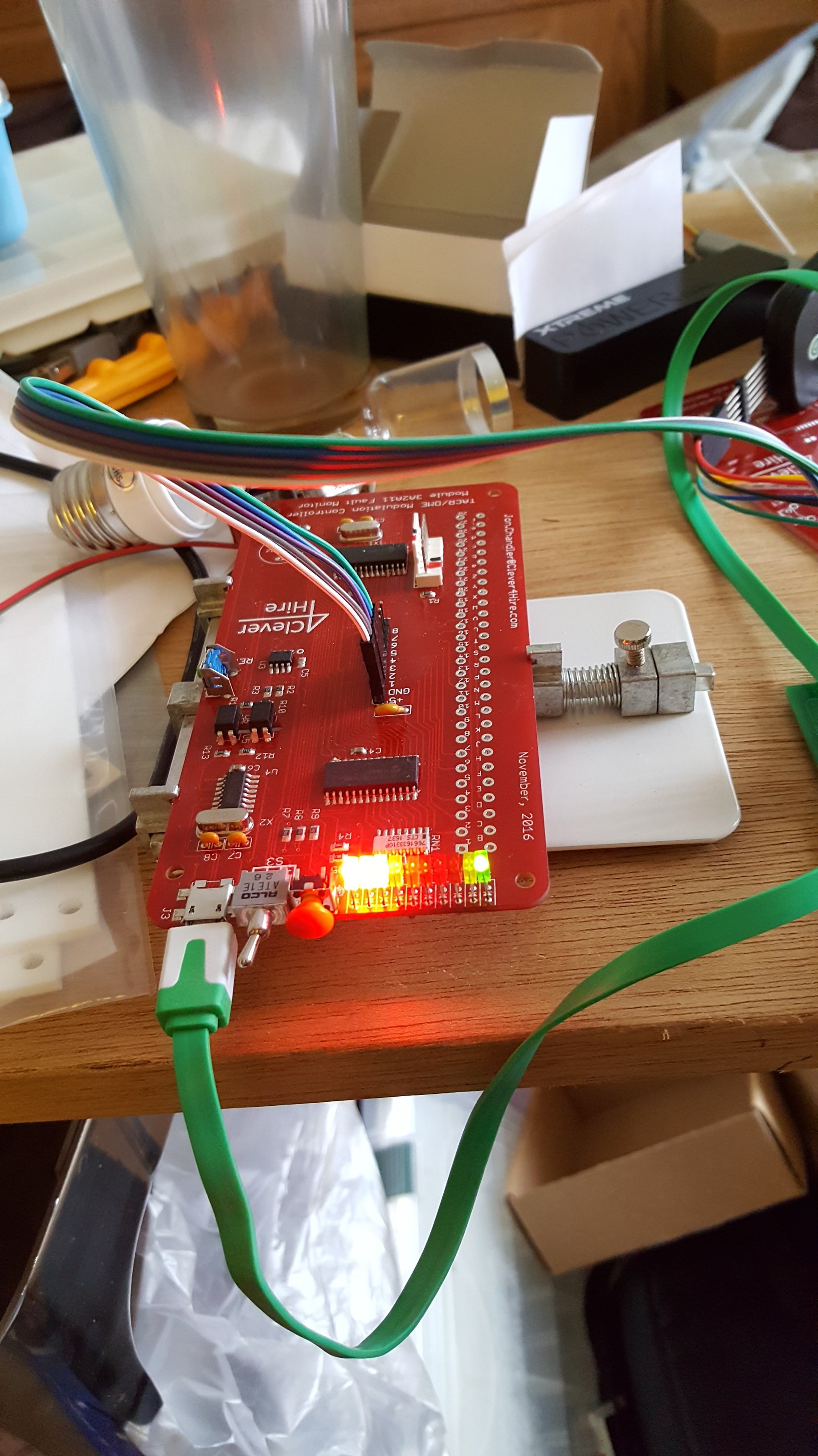

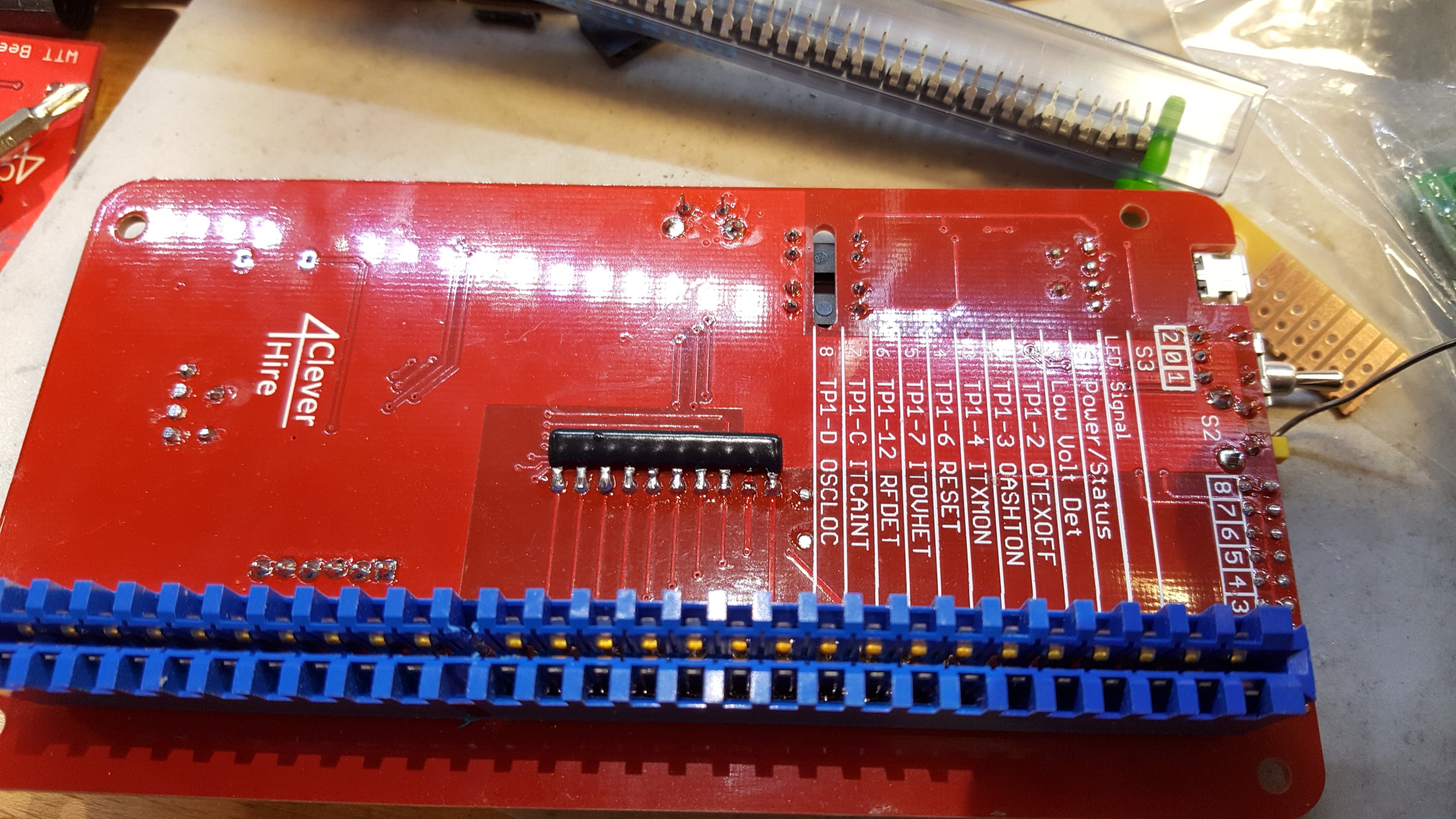

The picture below shows a 10k x 9 SIP resistor soldered across port B. The common pin is connected to +5. If you look closely, you'll see the 2nd pin is clipped off. Pin 2 is ground.
The second picture shows the top side of this board working. This board has been programmed hundreds of times over the last month. 4 more identical boards have been programmed many times over the last 2 weeks.
Your advice is good. Your conclusion on why you had problems is erroneous. It wouldn't be the first time your circuit isn't quite what you thought it was.

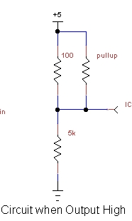

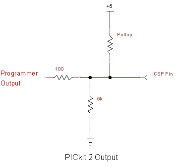

The PICkit 2 schematic shows there is a 100 ohm resistor in series with the lines to the programming pins and a 5k pulldown to ground.
When the programmer output is high, effectively there is 100 ohms in parallel with 10k pulling high, and 5k pulling low. This is equivalent to a voltage divider with 99 ohms connected to +5 and 5k connected to ground. The output voltage when the pin is high will be 4.9 volts.
When the programmer pin is low, the equivalent voltage divider has 10k connected to +5 and 98 ohms to ground. The output voltage from the voltage divider will be 0.049 volts.
Not even close to causing a problem. The weak internal pullups are equivalent to about a 100k pullup resistor as I recall? That changes the above calculations....not at all.
10k pullups are safe on port B with a wide margin of safety. You need to look for another can of your problems MrDEB. physics proves you wrong in this case.
Clarifying, the output circuit looks like this. A 100 ohm resistor is in series with the PICkit output pin, and a 5k resistor pulls down to ground.
When the output is high, the circuit looks like this. A voltage divider is form with the 100 ohm and pullup resistor are connected to +5, with the 5k resistor connected to ground. If the pullup resistor is 10k, the output voltage when the signal is high is 4.9 volts with a 5 volt supply. Any lower value resistor will move the output closer to +5 so the high level output is not a problem.
When the output is low, the circuit looks like this. The pullup resistor is the top part of the voltage divider. The lower part of the voltage divider is the 100 ohm resistor in parallel with the 5k resistor. The equivalent resistance is 98 ohms. If the pullup resistor is 10k, the output is 0.049 volts.
If the value of the pullup resistor is lowered, the output voltage will be increased. With a 5v supply voltage, anything level than 0.75 volts is low. You'fe have to go far lower than a 10k pullup to have a problem meeting requirements for high and low signal thresholds.

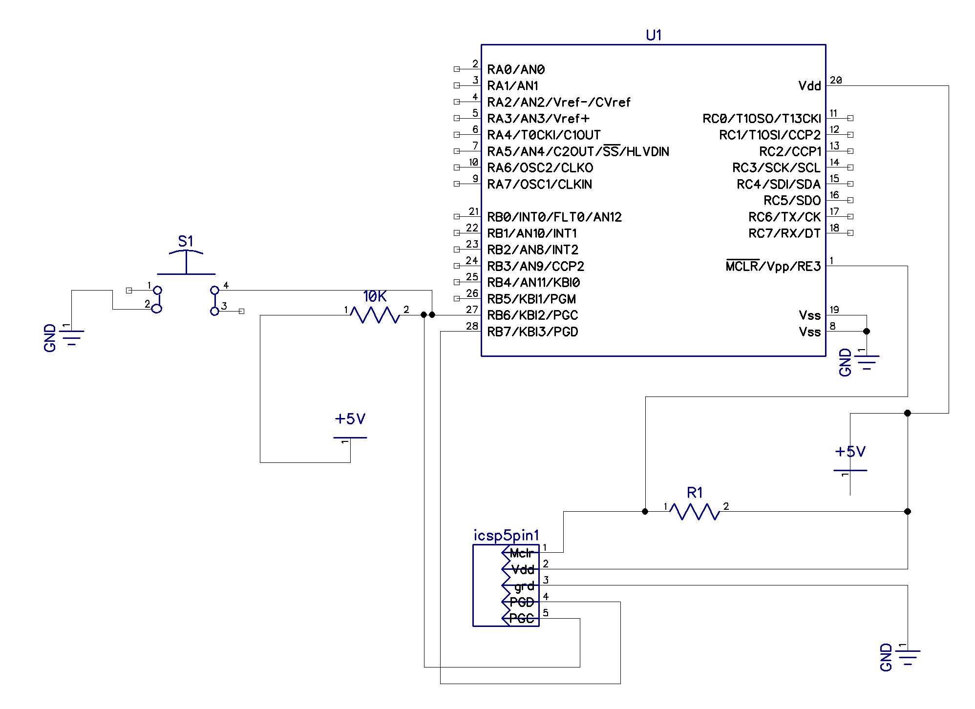

Maybe an issue with circuit description. Here is basically what I had when I incurred a programming error using a pickit2
hopefully clarify what I did. IMO it is applying 5+ to the portB6
That is what a pullup resistor looks like. This did not cause your error.
That now has me wondering WHY when I removed the pull up the error does not come up.
Question is applying the pull-up are you not applying 5v to portb6
