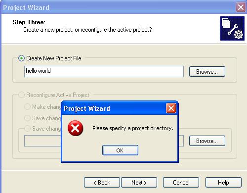

how am i supposed to know where it saved the assembly program?
step 4 of the project wizard is a tad perplexing
the assembly file i saved is NOT in the list....
Try it like this
Prior to doing any steps on the poster create a dir for your project. You may want to keep all your projects in a dir called PIC_PROJECTS. So create the dir C:/PIC_PICPROJECTS/HELLO
Now do the steps in the poster.
In step 2
Do File/ Save As… C:/PICPROJECTS/HELLO/HelloWorld.asm
In step 3
The project wizzard will want to know what the project name and directory is. You can pick the name but use C:/PICPROJECTS/HELLO for the dir. This makes sense since you already have your HelloWorld.asm there.
If you do that HelloWorld.asm will show up in the list and you can add it.
I hope that clear it up.
thanks so much , that helped :)
