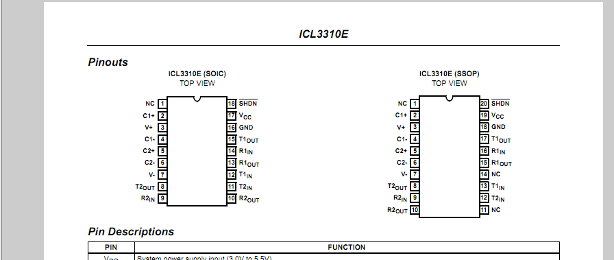

oh no sir ICL3310E is +/- 15kV ESD Protected, +3V to +5.5V,1 Microamp, 250kbps, RS-232
Transmitter/Receiver not my Requirement. which 3010 ic used my in tv remote .it o\p RC5 protocol add value 0x00 & commend value as allways used ie. 1 2 3 4 5 6 7 8 9 ect.....
There a datasheet for the what the op is asking but I think he has the wrong chip the SL3010 is for (RC-5) infrared
remote control system. It's 28pin chip the plain jane 3010 is a 18 pin chip made by the same people but it rs232 chip.
