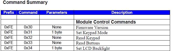

I got a question though.
What if the "register address" is actually two bytes - Prefix + Command (see picture attached).
If I want to read Firmware version - 0xFE 0x30 - what would the sequence look like?
Would it be:
send start (SEN=1)
send device opcode with R/W clear (write) (A7,A6,A5,A4,A3,A2,A1,0)
send Prefix (0xFE)
send restart (RSEN=1)
send Command (0x30)
send device opcode with R/W set (read) (A7,A6,A5,A4,A3,A2,A1,1)
read data (Do you need to set here RCEN bit to 1?)
send stop (or I guess, just don't acknowledge) when you've seen enough data. (NACK)

One of the problems is that the names of the bytes change between different manufactures.
I don't think that you need to send a restart unless you are changing from reading to writing.
Can you post the datasheet where that table with the addresses came from?

The datasheet of the GLCD is here
I wrote the below stream, however all I get from SSPBUF is 0x01.
Even when I set Cursor to 0x08, and then read cursor, I get 0x01.
This is the stream:
send start (SEN=1)
send Prefix (0xFE)
send Command (0x30)
read data (RCEN = 1)
send stop (or I guess, just don't acknowledge) when you've seen enough data. (ACKDT = 1 [i.e. NACK], ACKEN = 1 [i.e. send ACKDT] )
send stop bit (PEN = 1)
Looks logical to you?
