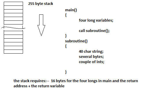

I need to see your main.... You appear to have a buffer
DisplayText[25][];
I can't tell how big this is but if "buffer" is 10 chars why would you need 25 of them.. That would be 255 bytes and overrun the stack!

Why do you need 10 strings??? I normal allocate enough for 1 then reuse it as it's only needed in one place..
If you need that amount of static data, then make it global then the stack won't destroy it..
Here's how it works:-
then the subroutine address and return byte and possibly 50 bytes.. if you call another routine the stack will already be at 68 bytes... You must also think about interrupts..... they also need storage.... Once the stack is depleted it starts to eat away at ram.. Its the programmes job to manage the stack...
