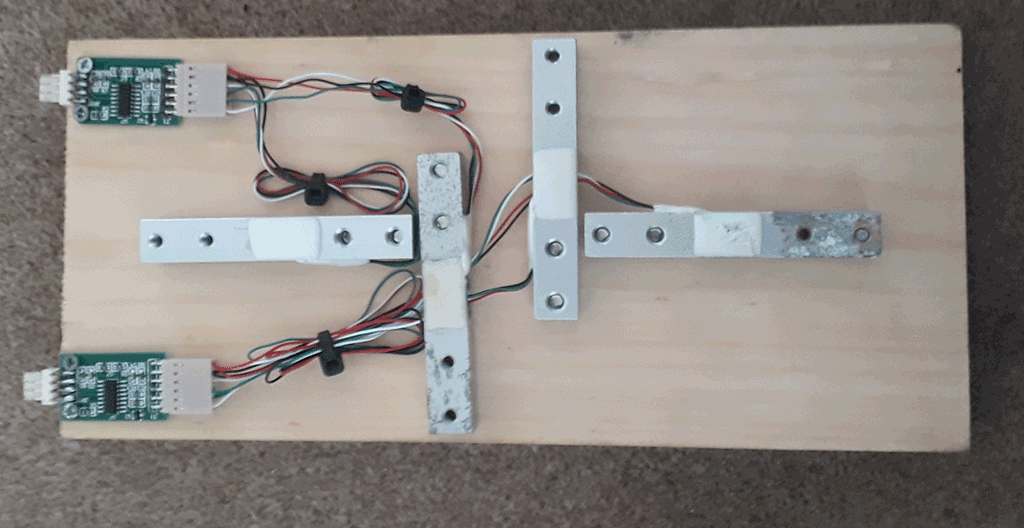

The weight sensors seem to work well but I discovered something disappointing. The circuit boards contain a two channel ADC so I was reading two sensors with one module. They can be read at 80 times per second but when you change channels there is a wait time of almost half a second. This means that an ADC module will be required for each sensor. I can (currently) only find three sensors even though I'm sure I bought four. I will persevere to see if I can get forward/backwards to work.
Edit, does anyone know a way around this slow response?

Is there any reason you're not just using two weight sensors? i.e. one for X and one for Y. They will give a positive reading if you push, and a negative reading if you pull. Just put a fulcrum in the centre of the foot board.
As an aside, the two channels have different gains; channel A is x128/x64 and channel B is x32, IIRC, and as you said, there's a delay when changing channels, and on the first sample. Have you tried using a MUX to measure different voltages? I'm assuming it wouldn't work, and also assuming that the ADC has an internal strong LPF.
Thank Dougy for the advice but it would be i think a bit too much complicated for me to make and no garantee it will work as intended and the budget is already in the red so i think i will go for the simpler solution with switchs link to keyboard keys.
