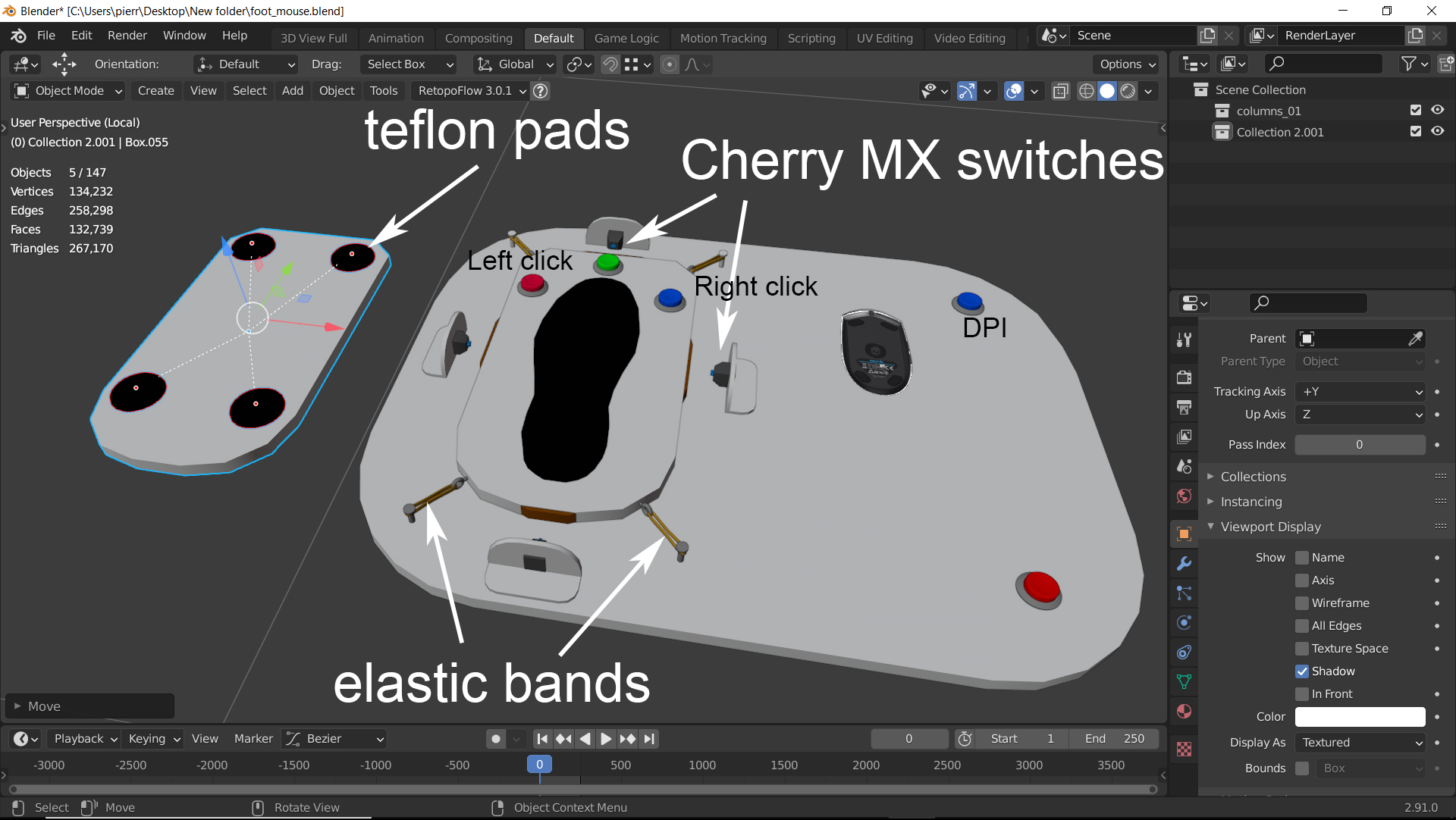

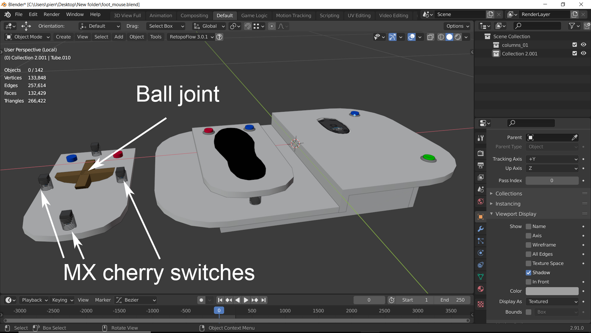

After a few days of thinking and seeing multiple projects and mechanisms i came up with 2 ideas and i have already made my choice on the second one since the simplicity and stability seem to be the better choice.
After reading a lot on accelerometer and gyro i decide to discard these solutions because the player would have no stability for the cursor since it's pretty hard not to move at all the pedal when the foot is on it. The solution is rather simple since to be able to play fps games he only need to have control of both the movement wasd and the position of the cursor + a few extra buttons like dpi, left/right click and even a jump button on the top center of the pedal. This way he can easily move and control player camera.
This one was the first concept but the ball joint made it very unstable to tilt even with springs for clicking the buttons and it require more work on the board that need to be fit so the pedal was on same height.
This concept is the one i think will be easier to build and would give optimal result since the foot pedal is mounted on teflon pads and stabilize with elastic bands to maintain it centered. The elastic bands need to have the correct tension factor so the pedal could glide to trigger the switches without too much effort and be hard enough to avoid accidental push on the pedal. I thought about springs but they often become looser after awhile and elastic bands are cheap and easy to replace.
Now i need to figure out how to connect all 4 cherry mx switches and the jump and maybe another optional button, so far from i have read i would need an arduino UNO for this work and it should be recognize as just another keyboard by windows but i am still not sure what would be the best way to do it so if you have the knowledge then feel free to share with us. Also critics are welcome since many heads are always better to get the best solution possible.

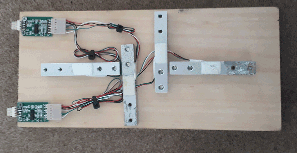

The weight sensors will each measure up to 5kg - so 20kg total. They will bend (very) slightly when a load is detected. They can be set to zero at any point so your friend could place his foot on the board and the sensors could be zeroed. A push on the ball (of the foot) will see the front sensor increase and the back sensor decrease. Same for left/right. The Leonardo can read these sensors and move the mouse at a speed relative to the difference in pressure. It might even be possible to tap the plate to represent a mouse push.
As I had some of these sensors lying around (from an earlier project) I quickly knocked together this.
There is (of course) another wooden board which goes on top.
The two circuit boards are (dual) Analogue to Digital converters so the scales can be read.
I have a Leonardo handy so will attempt to write some code when I have time - probably at the weekend.
I'm hoping everything still works as two of the sensors are very corroded.
I'll let you know how it goes.
BTW, Sensors and boards work out about US$5 a pair.
Anyone know of any reason why I can't use two sensors with one HX711 board? I've hooked the (excitation) supply to both sensors and wired the green and white wires to the two channels but nothing seems to be working. Probably a mistake between keyboard and screen and I'll double check tomorrow. Beer time now.
